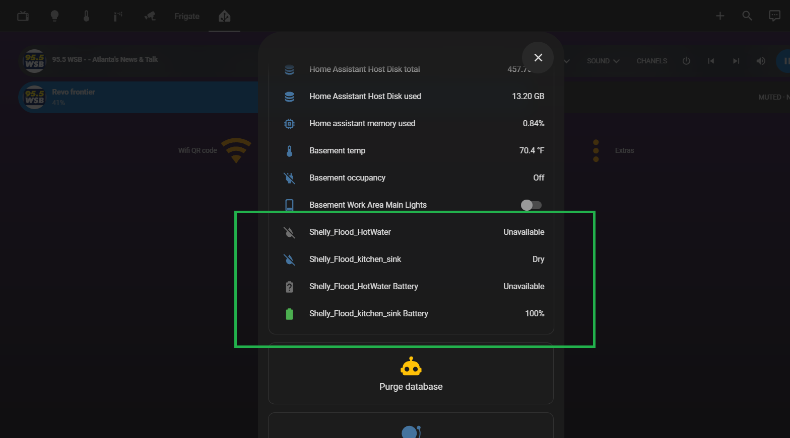

My Shelly Flood Gen 4’s show unavailable. They are doing what they are supposed to do in zigbee mode. Is a battery saving thing when they go to sleep. They come on and report for a few then back to sleep, wake up immediately when moisture is detected etc. when they sleep I get “unavailable” for both the battery, and wet/dry state.
Is there a fix to show what the last state was instead? I was thinking about using a helper or something to save and view the last known state instead of the current state. Cant seem to find anything in helpers though.
