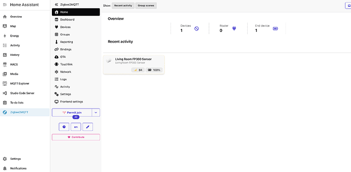

mini PC, Sonoff Zigbee 3.0 Dongle Plus (Currently disabled as MQTT was not working if this was enabled), Reolink Cameras, Aqara FP300, Shelly Gen 3 Dimmer, Zigbee2MQTT all installed and working properly.

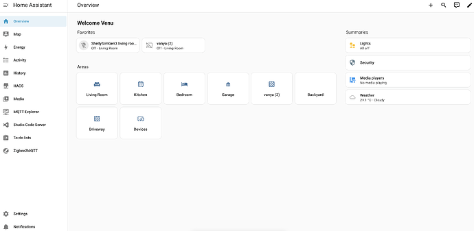

I have attached 2 screen shots, one is HA home view and another one with MQTT with FP300 sensor added.

I can currently use the Shelly Gen 3 Dimmer with my LED’s and I can dim the LED lights and turn them ON/OFF with the Shelly App or the Home Assistant.

Only the Shelly Gen 4 devices are supported, see: Zigbee2MQTT (search for vendor “Shelly”).
Gen 3 devices are wifi only. Not Zigbee.
Oh ok, Thats good to know.
Thank you.
