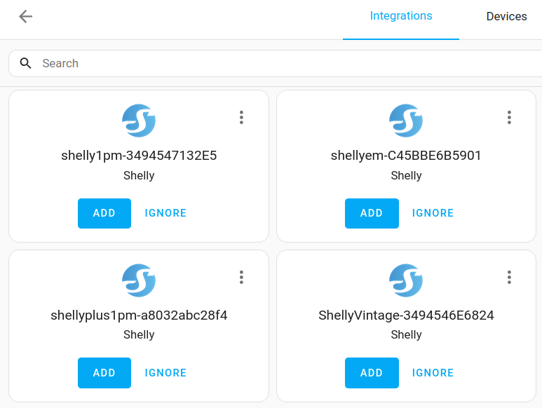

I did a quick install of HA OS on a VM in Proxmox as I wasn’t sure whether the integration was required or not as I thought it was deprecated? The new install automatically discovered my Shelly gen1 devices on startup:
From reading the Shelly docs it seems to be an mDNS discovery.

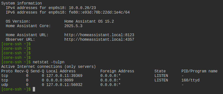

Netstat does not show the CoIoT port…

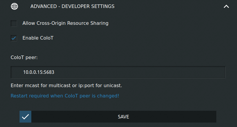

…so I configured one of my Shelly devices (on firmware 20230913-113709/v1.14.0-gcb84623)

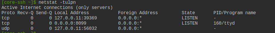

to use unicast/CoIoT, and gave it a reboot… and the result is oddly the same but the Shelly is functional:
So HA server and port, not just ticking the box?
There is no box to tick, it’s configured as unicast once an IP and port are entered, otherwise ‘mcast’ enables multicast.
