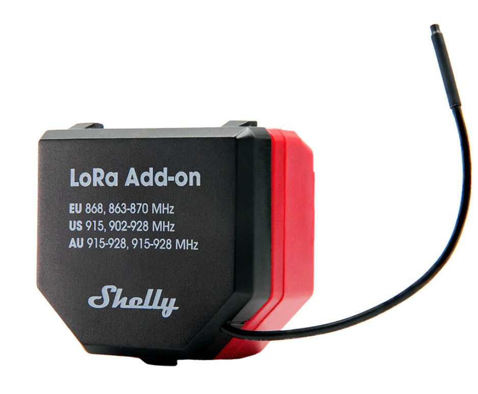

FYI, Shelly have now also released two new Zigbee products, (as well as a new “Shelly LoRa Add-on” for their Shelly Gen4 devices that can supposedly link two existing Shelly Gen4 modules up to 5km to “Break barriers and extend control where other technologies can’t reach”):

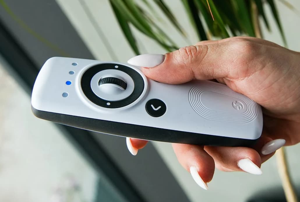

Shelly BLU Remote Control ZB (Europe only so far?) - a remote with Bluetooth and Zigbee connectivity for flexible control of smart devices:

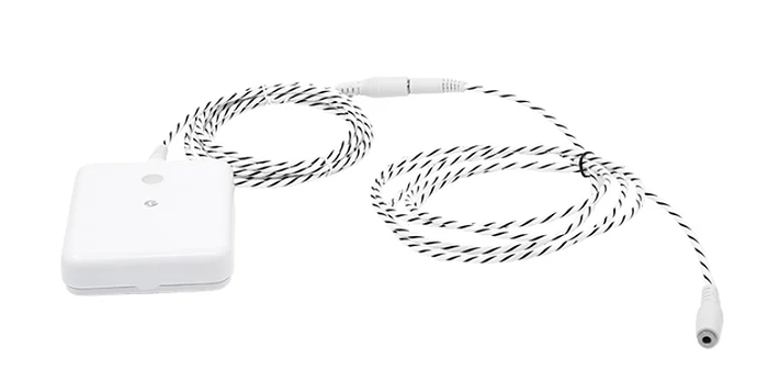

Shelly Flood Gen4 - a smart flood sensor with a leak sensor cable (released in both North America and the European Union + the UK)
This seems an interesting device to me. I have been looking for remote control devices for a while now. However, looking at the specs, it’s a bit limited. Apart from using it for lighting, I’d also like to use it for media control; it seems this one is not targeted at that.
