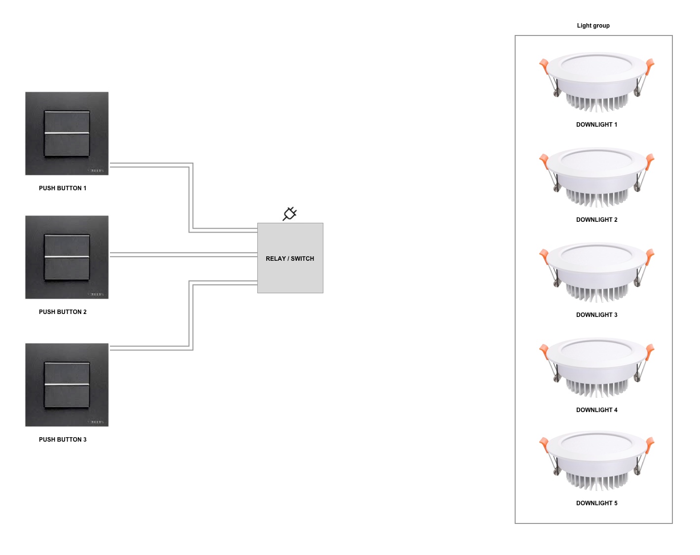

Hi @Ltek I’ll describe my issue or what I want to see if it can be achieved.
See the image:
I will have several push buttons (normal) connected to a zigbee relay. The relay is also connected to the power supply.
We will have several zigbee lights creating a group and connected to the power suply all time so they are always on zigbee mesh.
What I want is to use the push buttons to toggle the status of the lights and if HA is down been able to switch the lights. I would also be able to toggle lights from HA. Ideally it would be great to change dimming from push buttons but not mandatory. what I want is a fallback in case HA fails, and for my wife and kids for been able to use push buttons.
Thanks!

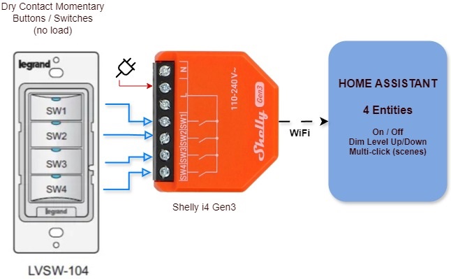

this blueprint has been tested with Shelly i4 (both DC and gen3) which do not control a load directly, aka ā€˜detached’. Since Shelly uses the same base code / command set, this BP should work fine for all normal Shelly relays (zigbee, wifi, bluetooth) which have a switch input (I think they all do). I do not have any other Shelly relays to test with so cant verify it.

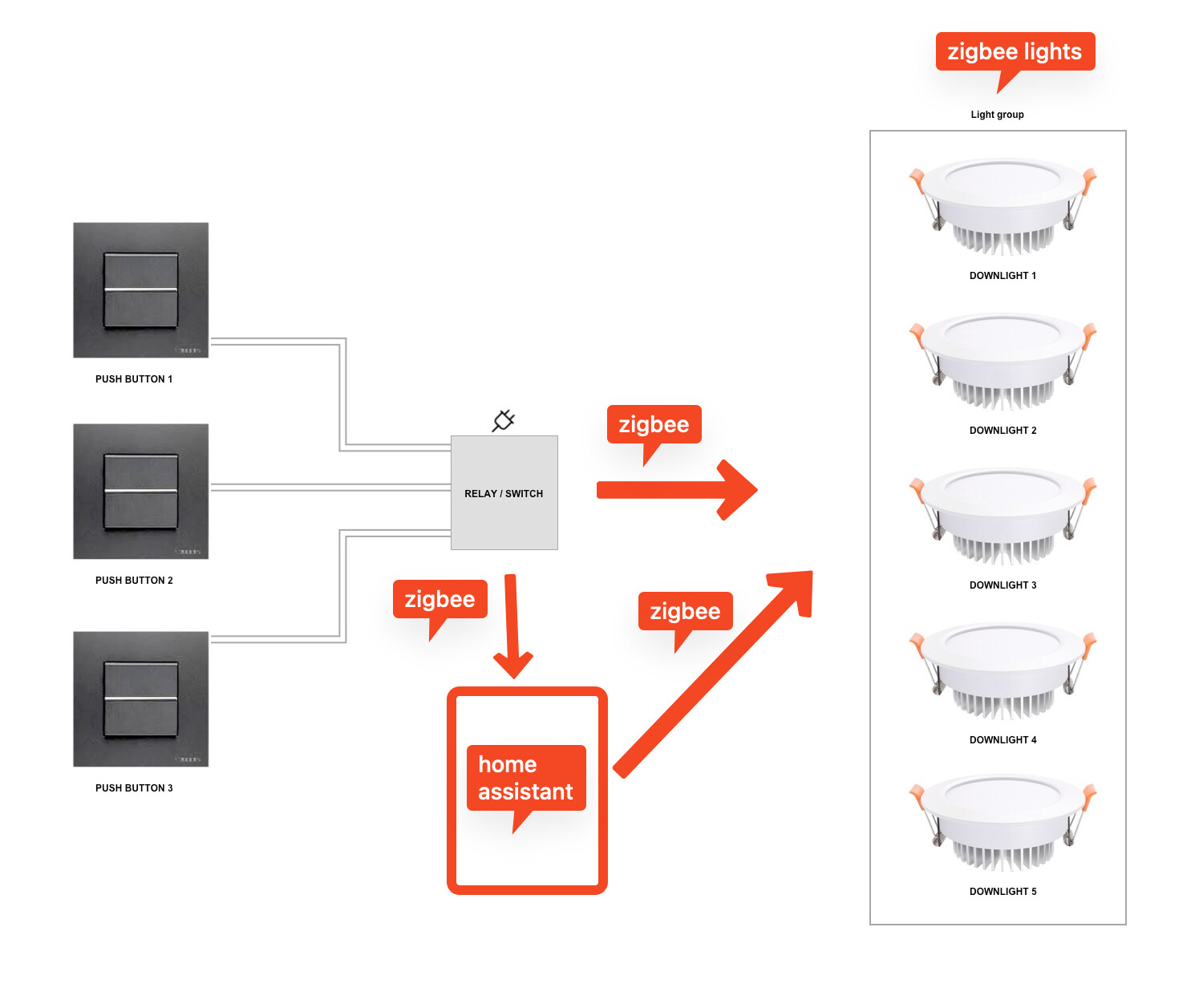

But this communicates directly with HA, what happens is HA is down @Ltek
I’ve redone the image
If not this blueprint, do you know how can i accomplish this?
as I explained, you need to use a normal Shelly relay, the blueprint will handle syncing with HA, and a normal relay has physical switch inputs. You literally have a diagram that shows exactly that. If your puck lights themselves are ONLY Zigbee, not connected directly to a switch (which is what a relay is) then of course you cant control them when zigbee is not running.

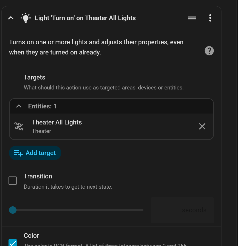

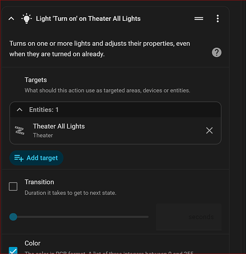

That has nothing to do with the blueprint.
Transition Time is set directly on the Light Entity. Add the Entity to the ā€˜Basic Actions’ on any button then set the entity properties/values as you’d like…
