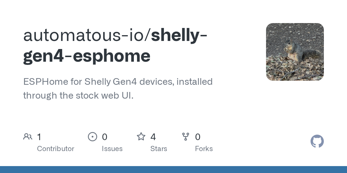

You could even ditch the shelly firmware, and re-flash them with ESPhome firmware :zany_face:

Thought about it, but couldn’t find where I download the firmware files
