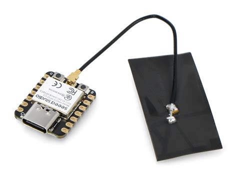

Weird thought perhaps, however does the Shelly you use now, can be fitted with an additional antenna to improve reception? Some modules have it by default and underneath, the devices are ESP…
Something like this:
From this chat evidently it appears not possible to have an external antenna attached: “Since Shelly has esp32 gnd bonded to mains live, also antennas ground plane is at mains…” ?

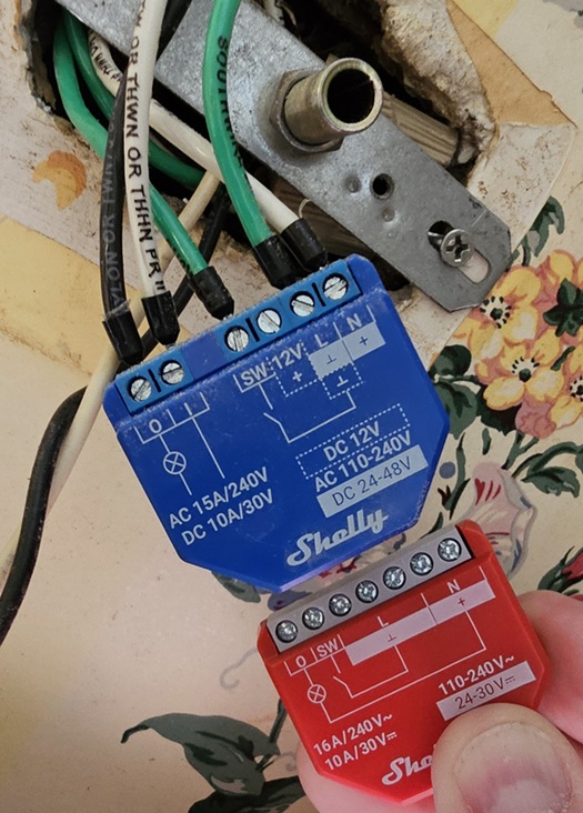

In this situation I am stuck between a rock and a hard place, to get the neutral the switch must be in the light fixture and there is nowhere else I can put it without getting an electrician in to run the wires for the shelly itself to somewhere further away from that wall.

Also it turns out I have to re-understand how the wiring would change anyway:

Would it be possible to put a different shelly that does not require a neutral (the only one I know of for 110v is the Shelly Dimmer 2, is there any other model*?) instead behind the wall switch (the wall switch IS NOT on the same wall as the microwave and that might be my only option)?
(*I had a couple years back stocked up on several Shelly 1L’s (which are discontinued) so that when the 1L I already have in the home dies. I would very much rather not use another one as it is an LED bulb I’d either have to switch to incandescent or then reopen the fixture and install a bypass, etc., etc.)
Note that in the US, green wire can only be used for grounding. It looks like the green wires are on the hot switched leg. The hot wire must be black. The switched wire can be any color except for green or white.

Thank for that info. Those are just short jumpers I used connected to the other wiring in the house. I’ll keep that in mind.
