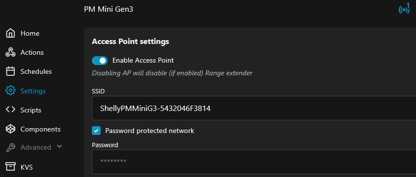

  1. on a Shelly device with a stable connection and AP function, go to Settings, Access Point and activate AP (set a strong password)

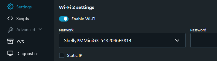

  2. on a Shelly device with a poor connection, connect it to AP-Shelly

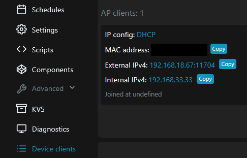

  3. return to AP-Shelly and click “Advanced,” “Device Clients.” Note the Client-Shelly external IP address and port.
  4. remove the Client-Shelly from Home Assistant and re-add, using the new IP/port. The device’s web page can also be accessed through this IP address/port
