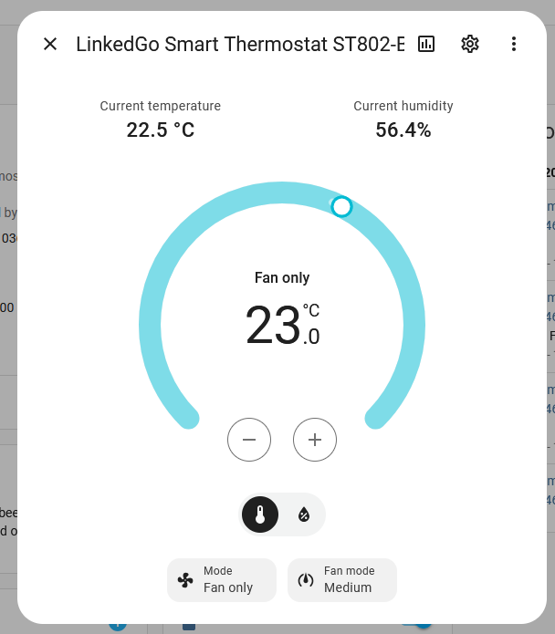

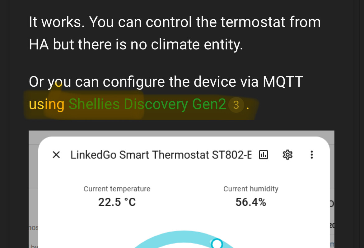

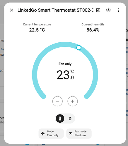

It works. You can control the termostat from HA but there is no climate entity.
Or you can configure the device via MQTT using Shellies Discovery Gen2.

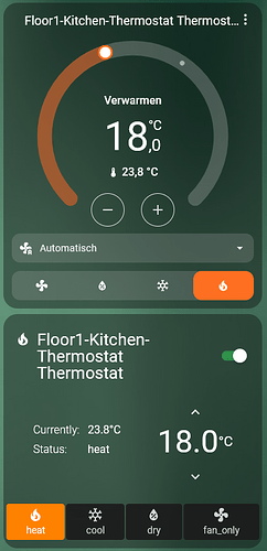

Can you show us how you have created that thermostat fan control?
Thanks, the Shellies Discovery Gen2 works great with this thermostat!!
Now we can use the Shelly LinkedGo thermostat within HA.
