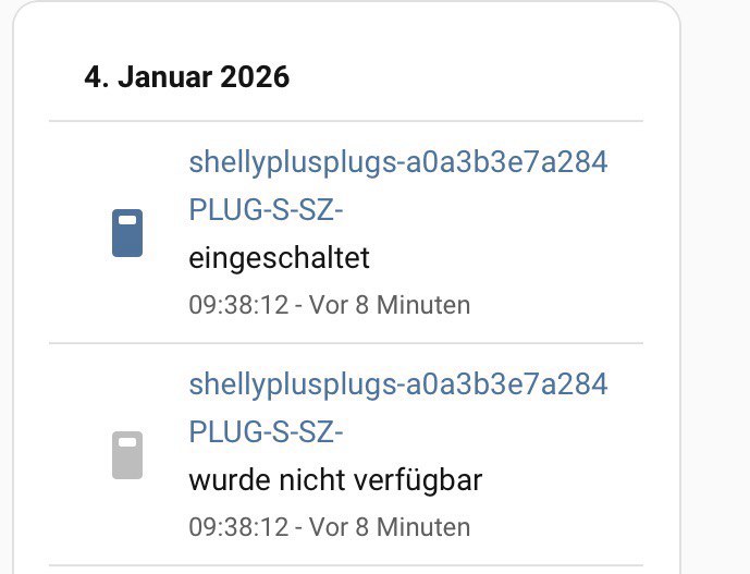

As you see the automation also was triggered when the PLUG was turned “ON”. But “plug turned on” is also triggered, if the Shelly “disappears” from the WLAN for a “millisecond” and comes back. This happens “occasionally”, I donno why, but rarely enough, that it IMHO does not matter.
The problem now arises (IMHO), when (as I did) check if the device is on, as I was confused a little. The german translation correctly says “unavailable” (nicht verfügbar) when it is basically “off WLAN”, but if it comes back, it says “ON (eingeschaltet)”, which I personally would rather translate to “verfügbar (available)”, or what did I miss?
See screenshot from what I got:
thank you for enlighten me.

You can probably use a not_from: unavailable clause in there.
It should be the state when the device is “nicht verfugbar”.

I solved the question for myself with checking if the switch of the plug is turned on/off. I just wanetd to find out, if the translation is confuding,or is there for a reason. If confusing, it should be changed, but if for a reason, the reason might be valuable for me.
