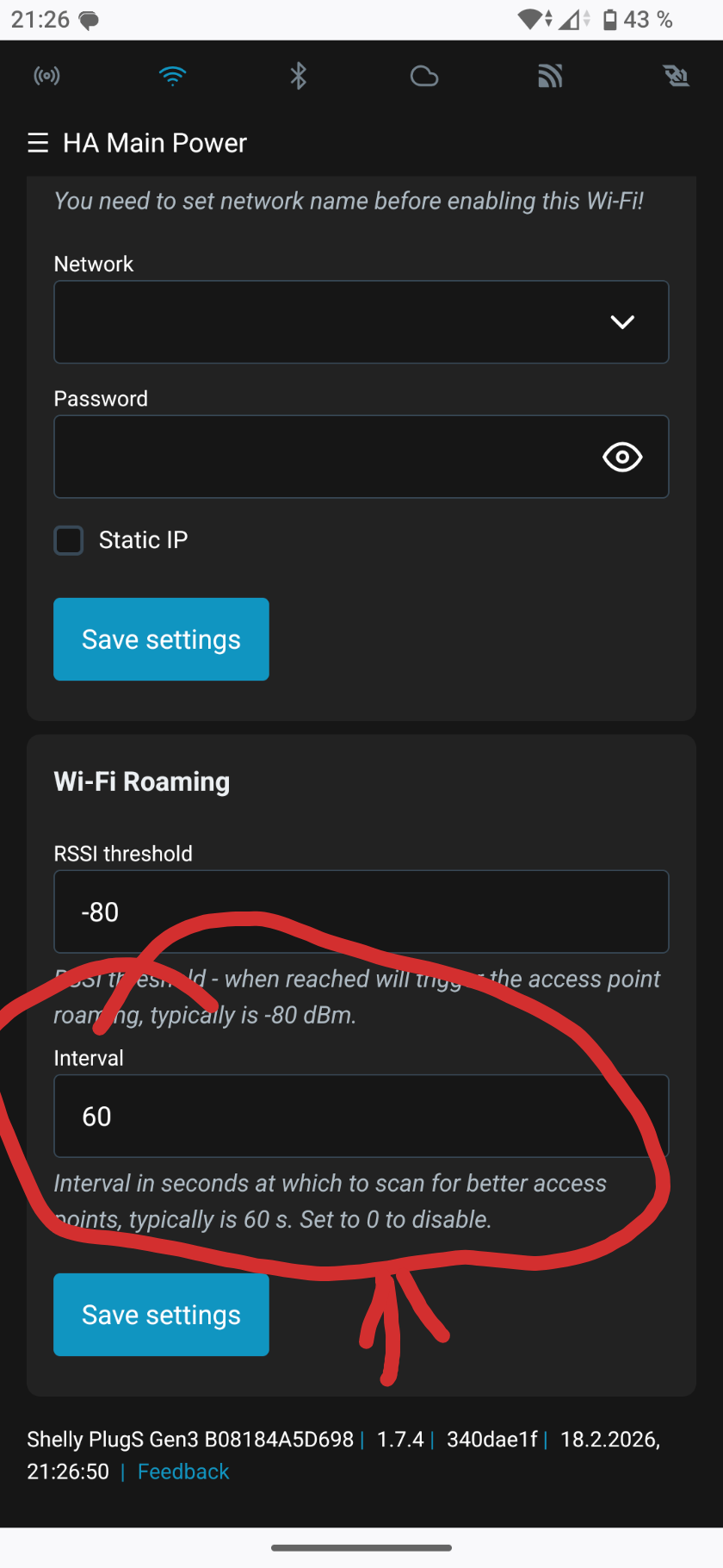

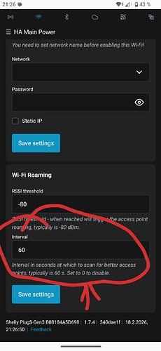

maybe i found a reason for the issue. My two AP’s in the house were set to 20 dBm Tx Power (EIRP). In the log i could see that the shelly devices were roaming between the two AP’s regulary. This is matching to what i watched. Somehow the transmit power was to high and the shelly devices “thought” the’d have to switch to a different AP. The blinking matches the roaming events in the ap’s log.
Well - not sure how to fix this. I lowered the Tx Power to 12 dBm to test. Let’s wait and see…
you can try to disable roaming in the Shelly itself
funny - i was not aware of this but i am quite sure it will fix my issue.
