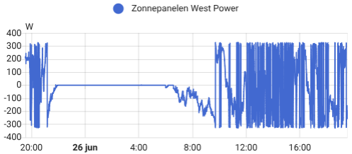

I’m using a Shelly PM1 to measure the output from my solar panels. Energy measurement is fine but the power measurement is strange. Power readings never exeed +300 or -300 Watt. I use Zigbee for the connection.
What could be wrong?

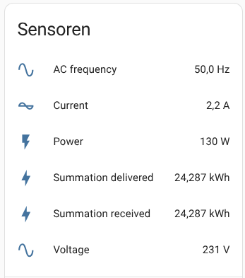

The other readings from my PM1 are more or less fine the summation deliverd and received are the same.
The value in the Shelly interface is ok, so I think it’s going wrong in HA

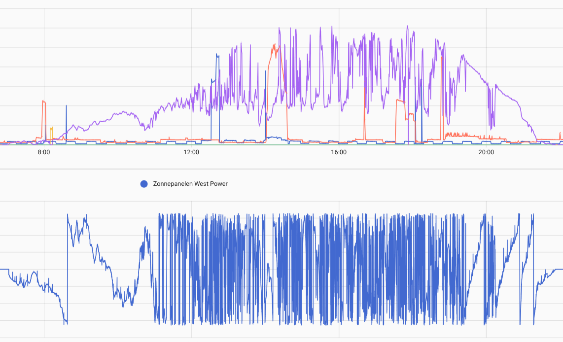

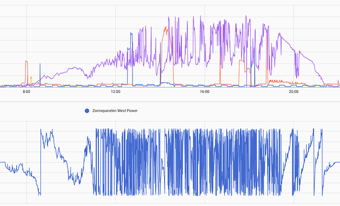

In the graph below you see the purple line (power production phase 2) measured by th kWh meter and you see the Shelly power in the lower graph. As soon as the Shelly value comes above -300 it changes to +300 etc.
Yes the value is negative if I connect to the Shelly bij http but somewhere in HA the value get mangeld.
I didn code anything just connected the zigbee sensor
This is “fixed” in the 1.7 beta firmware from Shelly. I put quotes around it because they’re now reporting 23W when it’s 2300W. But at least they got rid of the 300W wraparound…
