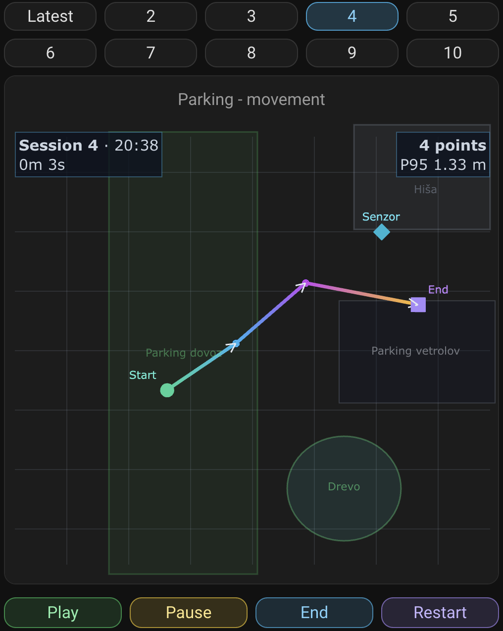

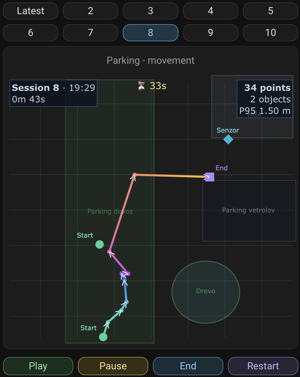

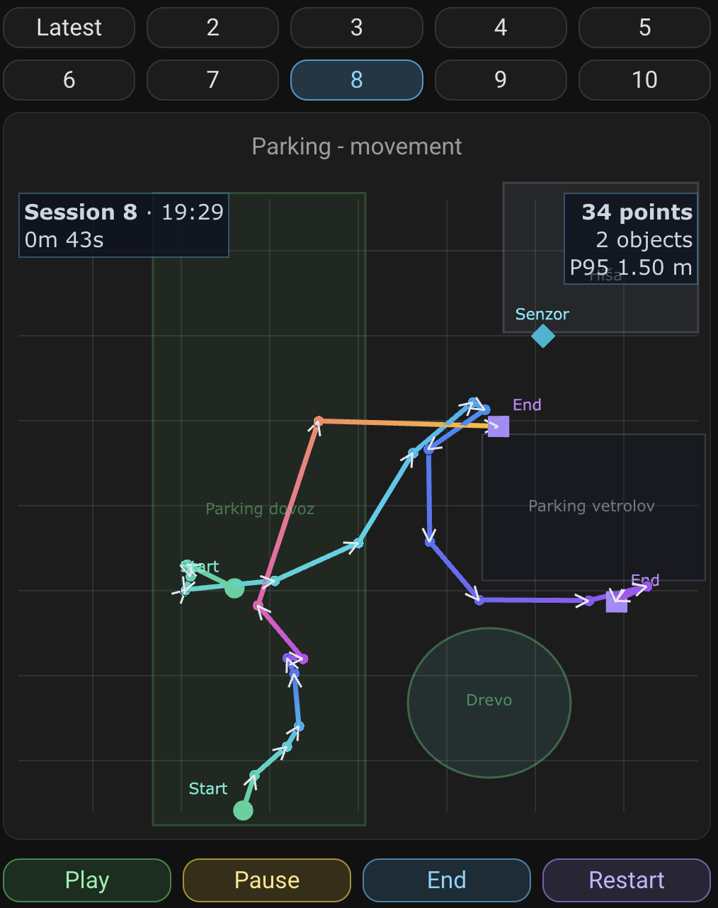

High-level overview of the Plotly Card YAML
  • Reads my sensor history - it pulls the last 48 hours of data from my presence sensor. Each reading contains information about where an object was detected and how tall it measured.
  • Splits the history into separate walks/sessions - a new session starts whenever there is a gap of more than 20 seconds or when a continuous stretch exceeds 3 minutes. It keeps the last 10 sessions, ordered from newest to oldest.
  • Separates individual objects - points are grouped by object id, so if two people or cars are moving at the same time, they appear as two separate paths instead of one confusing zig-zag.
  • Draws a top-down map - I use a rotated diamond-style view where each path is shown as a green-to-amber gradient line, with the color indicating the direction of travel. It also includes dots for each measured point, arrows showing heading, Start/End markers, the sensor location, and reference shapes for Parking area, House, Parking area II, and Tree.
    I had to do a lot of walking around the area and go through several iterations to get the object positions visualized properly. Very much a trial-and-error approach :grinning_face_with_smiling_eyes:
  • Shows session statistics - in the top-left it displays the selected session, its start time, and duration. In the top-right it shows the number of points, the number of detected objects, and the P95 height - roughly the tallest the object measured while ignoring extreme outliers.
  • Animates the tracked path on demand - I select a session at the top, which is shown in full by default, and then use Play / Pause / End / Restart to animate the path at approximately real walking speed. It also shows a countdown of the remaining playback time.

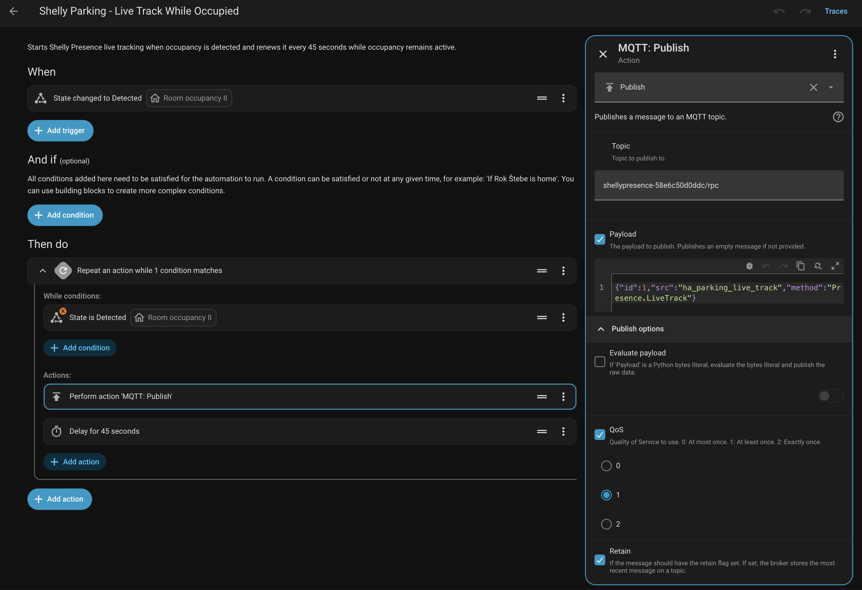

One thing I had to troubleshoot :cowboy_hat_face:
One issue I ran into was keeping the sensor “alive” whenever presence was detected. Otherwise, some tracking sessions would simply go missing :woozy_face:.
To solve this, I created a Home Assistant automation that keeps the sensor active while presence is detected, so it doesn’t drop the tracking stream. The automation is gated by presence, meaning I only “nag” the sensor to stream out data via MQTT while there is actually someone or something to track.
