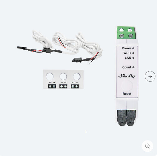

Here is “standard one” Pro, with clamps.

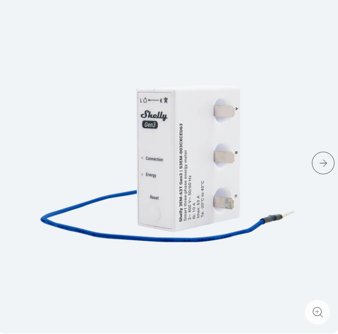

And here is 3CT63, offering a different form factor current transformer. It might be handy. But it is limited to 63A combined (by docs), while standard clamps allow measurement up to 120A or 400A per line.
There is also another interesting model, where electronics are packaged together with coils. There are two versions of this piece, with flat terminals (on picture) or with cables.

okay so in case i have 3x25A … 75A total … i cant use that one?
still no clue whats diff between 3CT63 vs PRO
thanks
To my opinion yes. Combined 63A doesn’t make any sense electrically here, they are separate channels.
“single or three-phase energy meter with a combined 63A, 3-phase current transformer.”
“Combined” in this context means that the CTs are in one block.
@karosm sorry i dont get it …
if i have 3x25A can i use that 63A one?
thx
Yes.
But I personally would go with Pro 3EM for flexibility.
@karosm thanks
what flexibility is on your mind?
but in full load of 3x25A … 63A wont be able monitor it, right?
thx
Flexibility of installation.
Anyway, it has 3 channels, each for 240V/63A.
which one are u referring to? seems 120A per Phase ?
How can I make it more clear…
Shelly Pro 3EM 3CT 63 has 3x63A current transformers in one block.
Shelly Pro 3EM has 3x120A separate clamps.
In your case pick the one more adapts your physical wiring, that monoblock doesn’t stretch anyhow.
The whole concept of “combined” doesn’t exist in electric wise!
no idea why it was discussed /described as “combined”.
