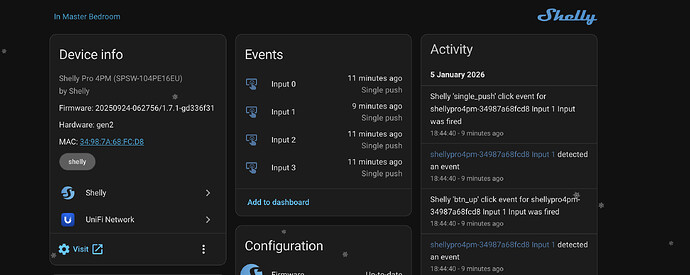

The weirdest part of all this? The events actually do show up in the device tab.
Am I missing something blatantly obvious, or is there a bug in the integration with the Pro 4PM?
