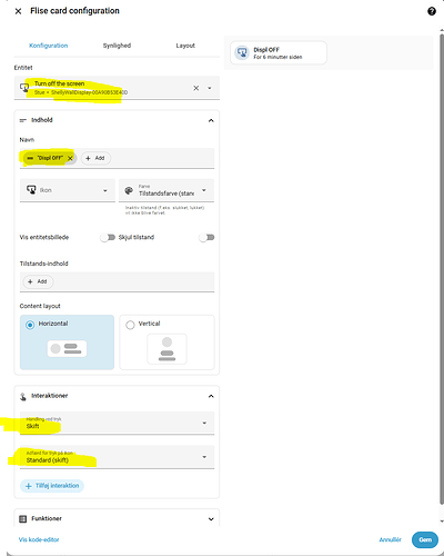

I can press this - and it works fine:
And had the plan to integrate this into a automation, but dont know how to do this
So basic question - how do I setup these information in an HA automation ?
Action in automation: ??? don’t know how to do:
action: button.press
metadata: {}
entity_id:
- button.shellywalldisplay_00a90b53e40d_turn_off_the_screen
data: {}
What I want in an automation is something like this:
actions:
type: tile
entity: button.shellywalldisplay_00a90b53e40d_turn_off_the_screen
vertical: false
tap_action:
action: toggle
features_position: bottom

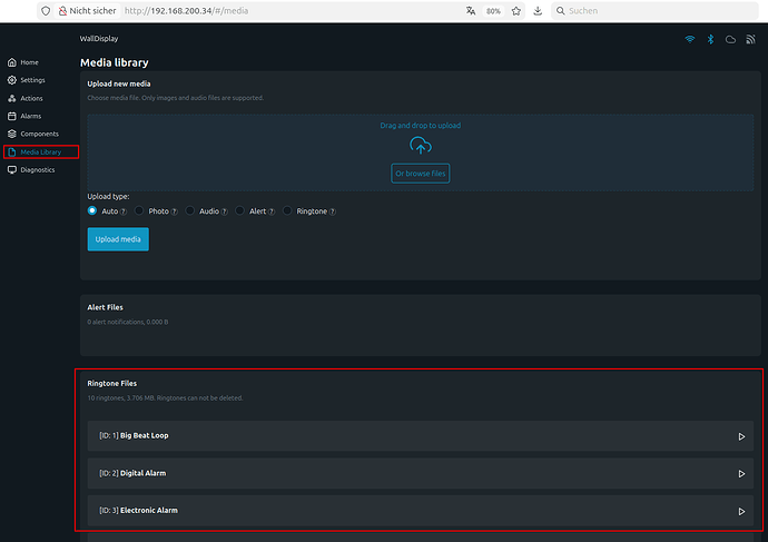

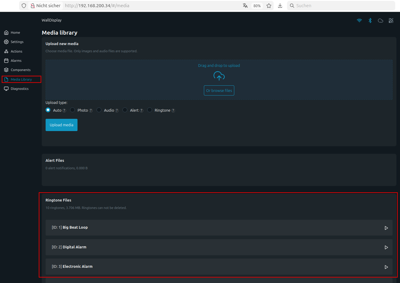

It is directly like in the above examples, look in the link above for useful commands, e.g. to play a ringtone from the pre-configured ones
follow instructions from above and add:
# data:
#   id: 1         # ([1..numbeOfRingtones])
#   volume: 8     # ([1..maxVolume])
shelly_display_play_ringtone:
  url: 'http://192.168.200.34/rpc/Media.MediaPlayer.PlayRingtone?id={{id}}&volume={{volume}}'
  authentication: digest
  username: 'admin'
  password: !secret shelly_password
and then you can play a ringtone like this:
action: rest_command.shelly_display_play_ringtone
  volume: 8
response_variable: return_struct
