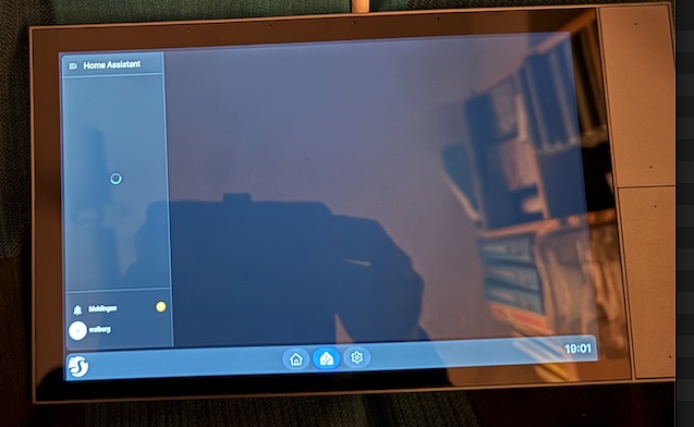

I have bought a new nuc with HA now i can login, but now after 7 hours there are just 2 rows on the screen, and a turning circle. So useless.
tried the stuff with adb, with Mac didnt work so i lend a pc laptop, ./adb does not work (the dot). and got: adbd cannot run as root in production builds. Too bad Home Assisstant does not run on Shelley normally as it seems, i can login but after 2 rows nothing happened:

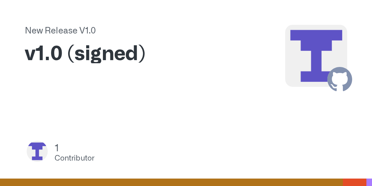

Hi @RienduPre
I was having the same issue so I’ve built a signed version of the app from @simllll’s source until they have time to fix.
