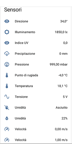

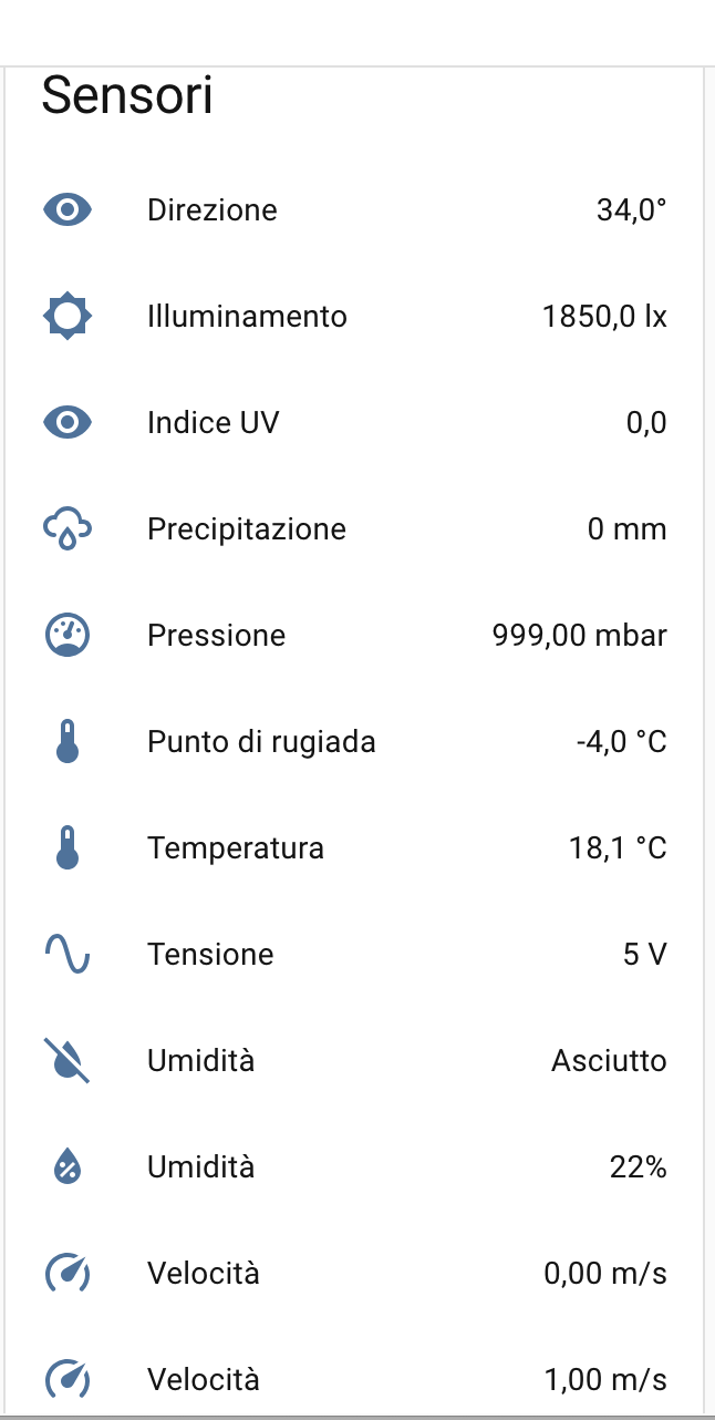

Solved positioning an esp32 bluetooth proxy in range and added with BTHome.
Now I can see sensors but, for example, direction is see as degrees…
Yes, that is the way the WS90 works. This is also the case if you have an Ecowitt basestation. You can solve this with a template sensor.
