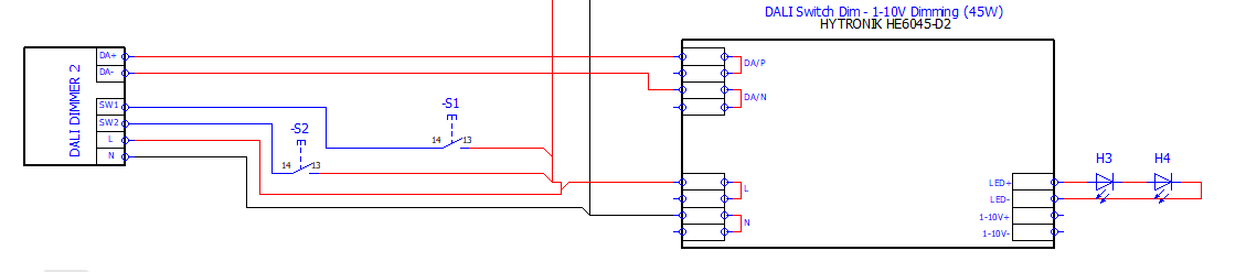

at the office building we wanted to dim our led panel lights each being 40W, we decided to try out the Shelly Dimmers - after connecting the PM2 it gave out an error that the lights are not DIMMABLE.
Therefore we realized we needed DALI Drivers - but we’re unsure how they work with Shelly DALI Dimmer… or can we use the PM2?

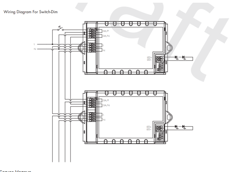

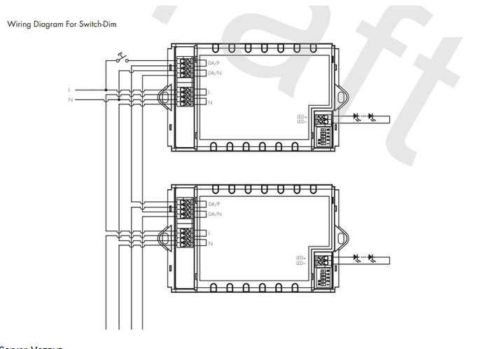

The drivers are supposedly connected to be switch dimmable like this:
Any recommendations, tips or anything would be helpful! It’s my first time meeting with the dali lightning system so i am unsure as on how to proceed.

Your description doesn’t sound correct.
So you tried to dim your panels with Shelly pro 2PM? Directly connected to panel or there was some other driver between?
And then decided to buy Dali-driver HED6045-D2, which is constant current driver…
In any case Shelly pro 2PM is phase cut dimmer, it can’t be used to control Dali-driver, neither it can be connected directly to panel that needs constant current source.
