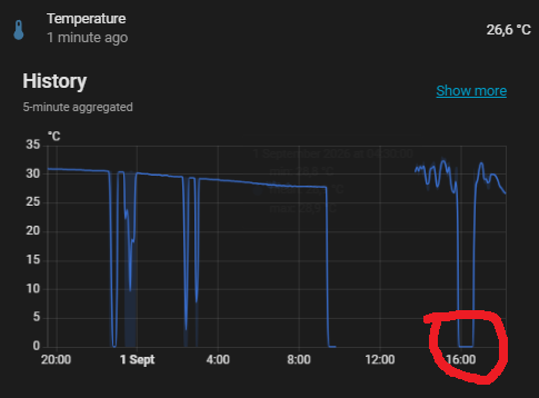

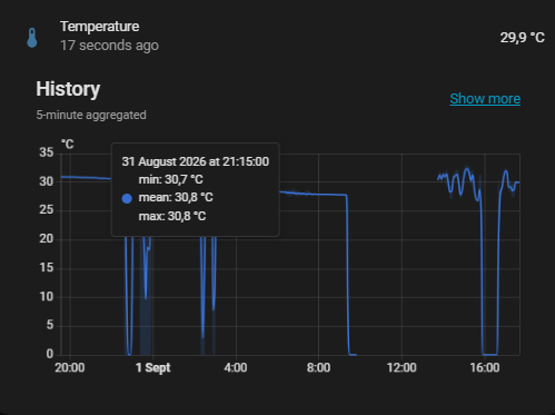

Shelly1 Gen3 + Addon + 2xDS18B20 - tried already 2 pair of sensor, replaced addon too, but I cannot get it working. 1 probe is 3m long, second is 1m long, They work for some time but then they stop working, temperatures drop to Zero and finally to unavailable and Addon says there is no Peripheral connected. I am already desperate.
Both probes are outside, in the pool, but Shelly1+Addon are in a IP44 box, everything is perfectly tied.
I connected the last pair of probes yesterday, they were found immediately by shelly web, they worked for 14 hours and then they dropped to 0 and after Shelly restart they dissapeared.

  • This second setup worked correctly for about 14 hours, reporting plausible, smoothly-changing readings from both sensors (temperature:100 and temperature:101).
  • On 2026-09-01 at approximately 07:26 UTC, both sensors permanently dropped to a stuck 0.0°C reading simultaneously, with no recovery.

I took it out of the water, the one, which was already in the water, let it dry, after about 30 minutes both connected again, then dropped out again, and so on in a loop… I should mention that the 1m one was not in the water at all…I am desperate.
I don’t know…hard to say…but I’ve seen a video on YT, where the guy had similar setup.
Update: it is not. It should be 316L Stainless steel. But I doubt that 14hrs expose to the water could harm it so badly that it stops and starts operating, additionally both of them at once. And of course, I checked all connections to addon + addon to shelly1…
Again some 40minut both dropped to 0.0C, now they hold since they returned.

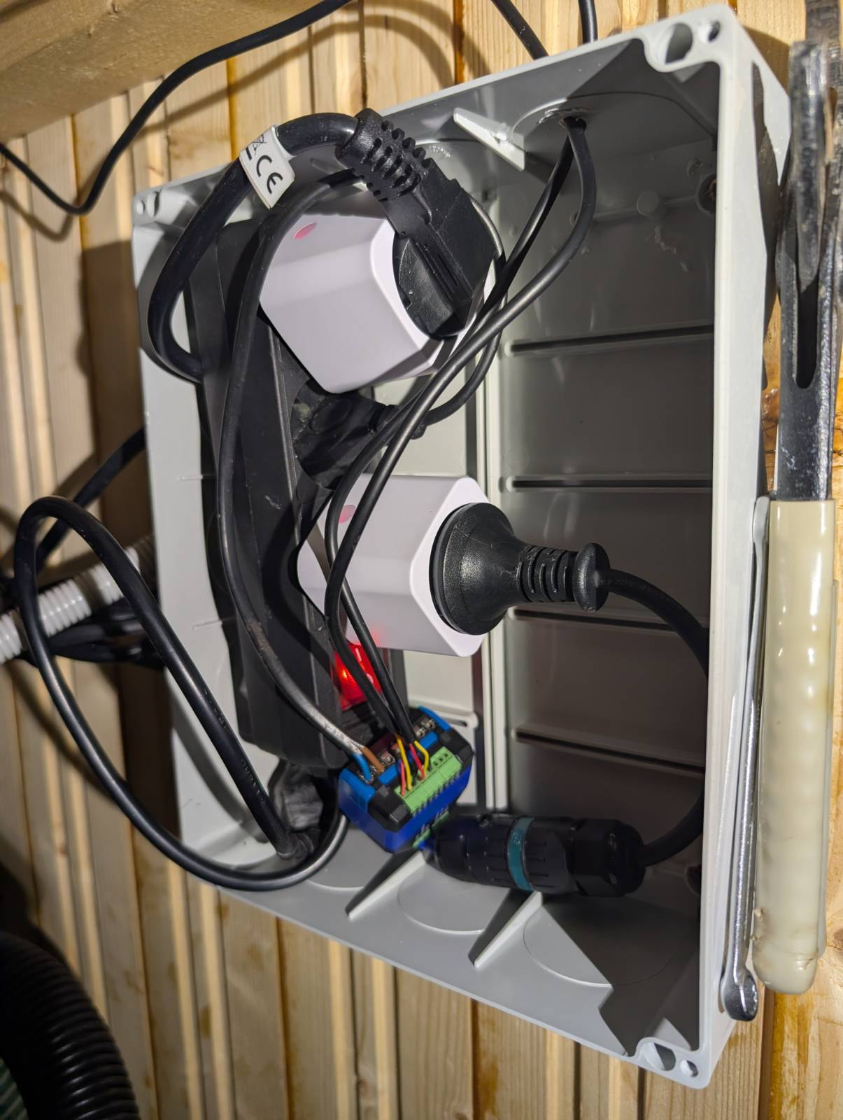

thanks. The truth is that Shelly 1 Gen4 with AddOn are in an IP44 box approximately 24×19×10cm. There is a power strip inside where the Shelly 1 Gen4 is connected, along with 2 Shelly Plug M sockets that control the pool pump and the salt chlorinator, in such a small enclosure, there is heat generated by the plugs/sockets themselves, but could there also be electrical interference? Omg…if so, how far would be OK to move Shelly1+addon from the box then?

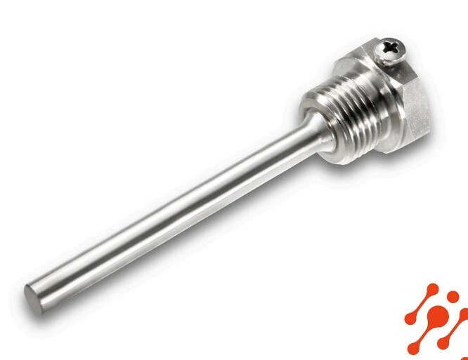

Thanks for the above article, wow! So I was naive :slight_smile: I think I will put the probe inside this and close it with epoxy completely. It will also act as weight and protection while kids are in the pool. It is 316Ti stainless steel- the factory confirmed today.

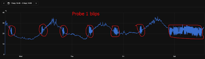

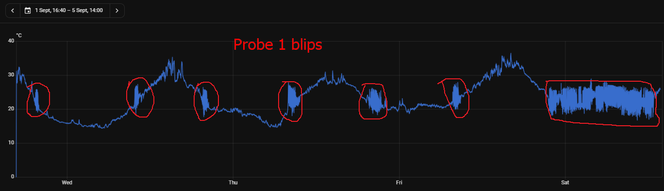

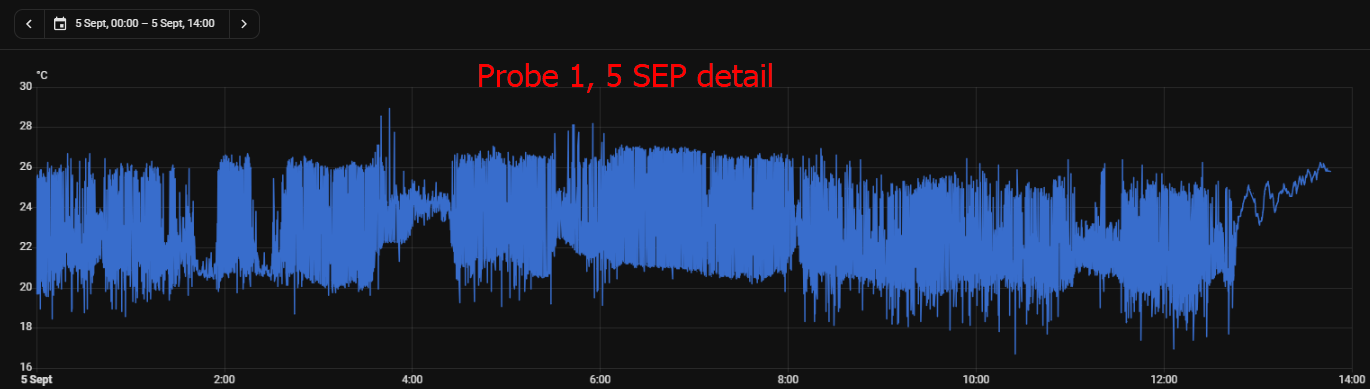

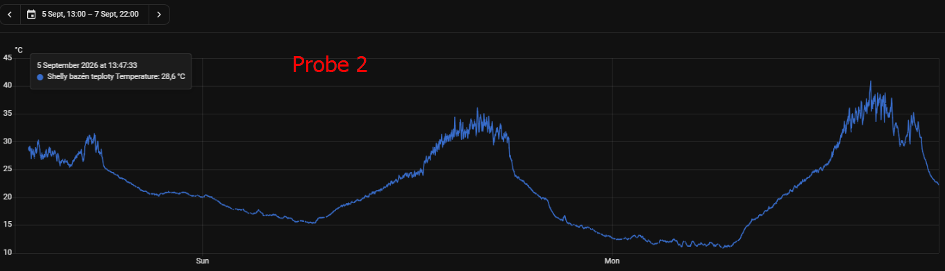

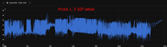

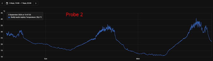

So I performed this isolation test, here are my findings:
disconnected one probe, left the other connected in dry air for ~4 days, then swapped. Both probes outside of the water during the test.
  • Probe 1 - this is the probe, which was in previously immersed in the water for 14 hours (test connected days 1-4): never went unavailable/unknown — but showed short episodes of implausible rapid oscillation (multi-°C swings within seconds). These episodes got progressively worse each day: ~19 min/day → 63 → 137 → 140 → 676 min/day (day 4), see the charts below. Disconnected after that.
  • Probe 2 (connected since, days 4-6): rock stable. Only a fixed-interval single-sample unavailable blip every ~361 seconds (6 min), lasting <1s each time, with zero drift in timing or duration over 48h/479 occurrences. No oscillation at all.
I could maybe live with rapid oscilation, I don’t know. I can definitely live with second probe’s blips.
I didn’t move the Addon further from the socket and box yet.
So your probe 2 is working. 6min “blip” is likely not related to the probe but something else in your setup.
Yes, actually both work. But not sure why that oscillation happens. Probe 2 - Claude in HA couldn’t find the reason.
