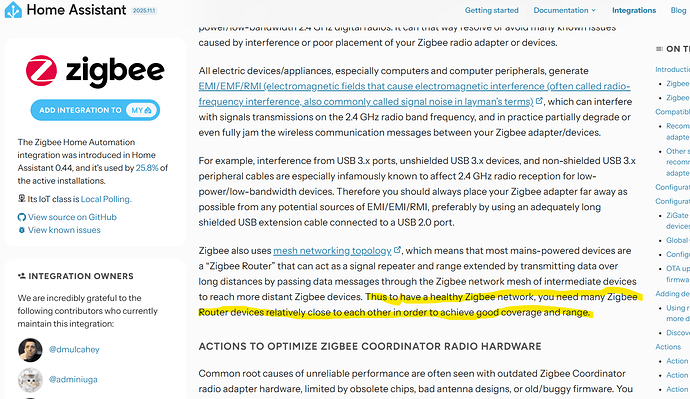

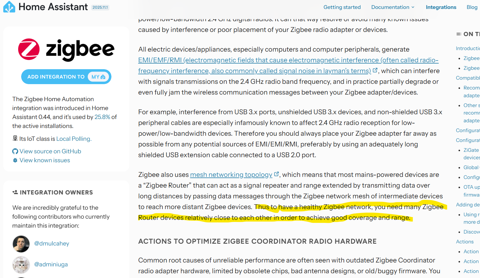

Are you sure about that? It says
Thus to have a healthy Zigbee network, you need many Zigbee Router devices relatively close to each other in order to achieve good coverage and range
It’s not connected via usb. it is connected via Ethernet. it is powered through the USB port. This was due to a recomendation that some users foudn a bug in teh SLZB firmware when powering it with POE.
I stand corrected.
