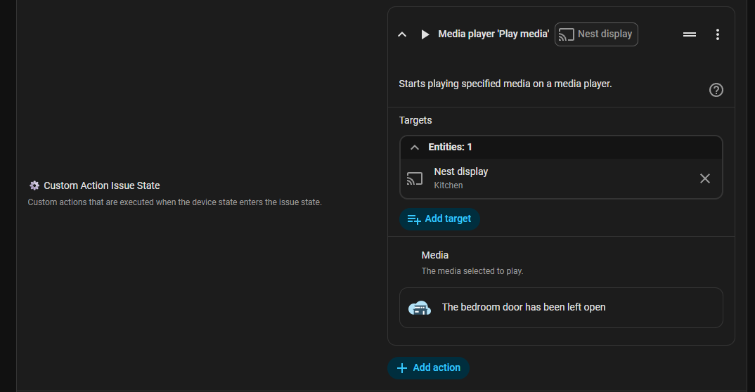

So I have an action inside a blueprint that uses TTS, in this example id like to use {{ friendly_name }}. As you can see it works for the display just fine, however when it comes to TTS it announces friendly_name…
is this maybe a bug/oversight?
