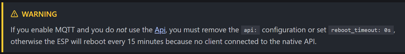

Yep, this is expected. There’s a warning about this in the ESPHome MQTT page:
That’s not it, I had reboots and crashes even when using API for Hass and MQTT on the second Pi for Node-RED.
