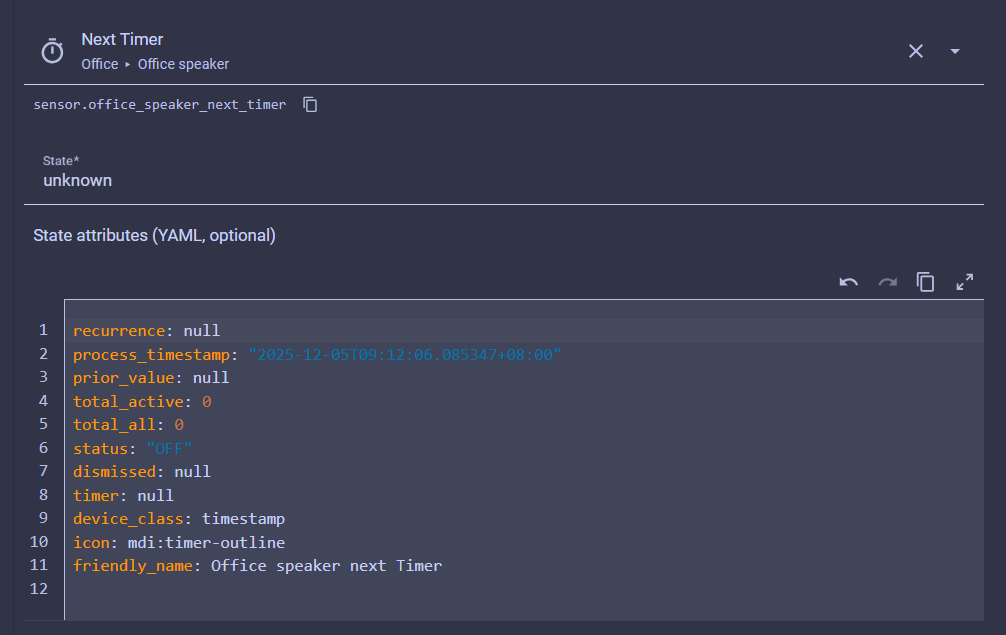

This has also stopped working for all of my Sonos speakers using Alexa, the timers have an unknown state. I think it began with one of the 2025.11 updates but I can’t be sure exactly when or why. I have a timer running right now on this speaker but nothing is shown:
There is a mod to the manifest to get the timers back, but looks like the format changed so the card no longer works. Going to see if I can make mods for it to work.
“requirements”: [“alexapy@git+https://gitlab.com/b366/alexapy.git@fix_api_notifications”, “packaging>=20.3”, “wrapt>=1.14.0”],

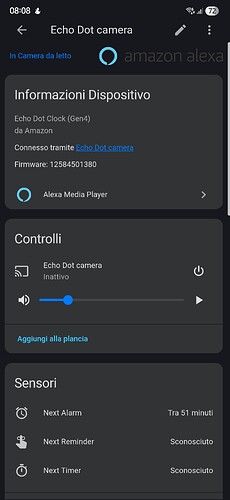

@firstcolle I’m having trouble seeing the alarms and timers on my Home Assistant, even with AMP 5.8.3. Where are you seeing information about them? They still show as “unknown” for me.
I only see them once they’re set, otherwise they’re unkown

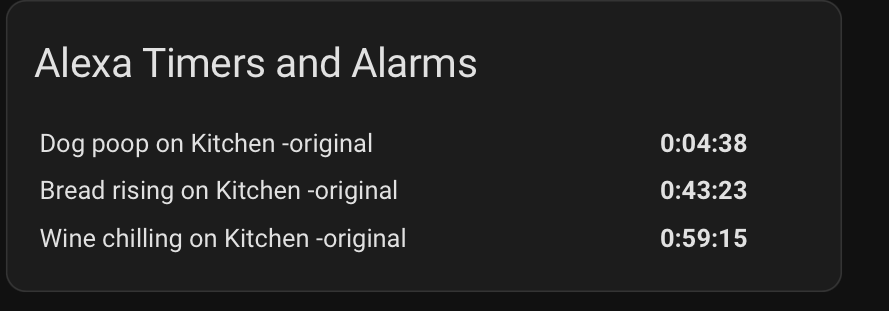

Okay, I have made an update to the code that will allow reminders, alarms, and timers to show. It’s not great, because Alexa Media Player changed the way that it delivered the information. I no longer have access to the original duration of timers, which I used to update the countdown. Now, timers are updated whenever AMP feels like giving it new information, which looks bad but is somewhat functional. Alarms are as before. Reminders and Timers only show the name of the most recent one (if it has a name) so all the rest are displayed wrong. Maybe AMP can update to give this information once more, I don’t know.
