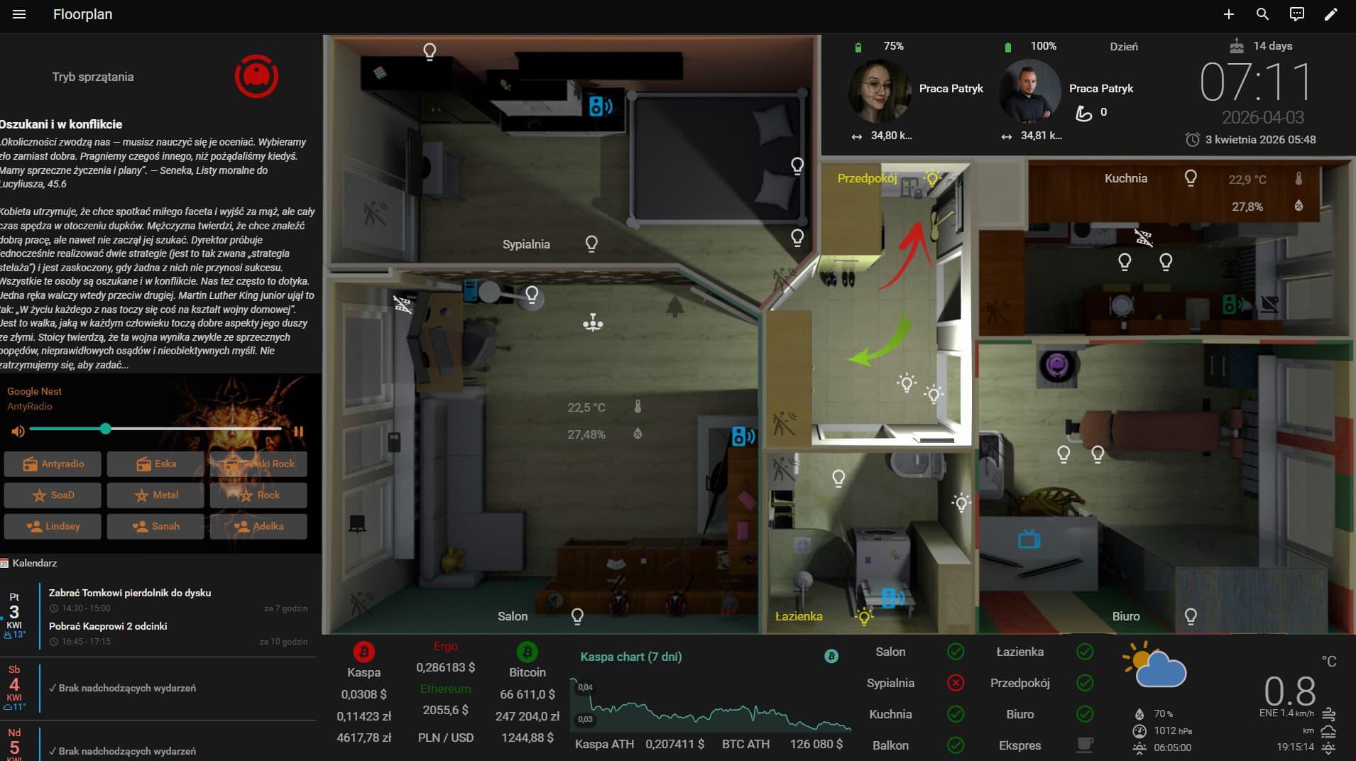

Proudly introducing my work :wink:
Normal mode:

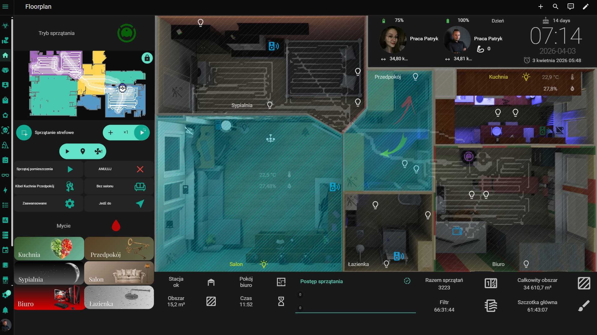

Cleaning mode:
