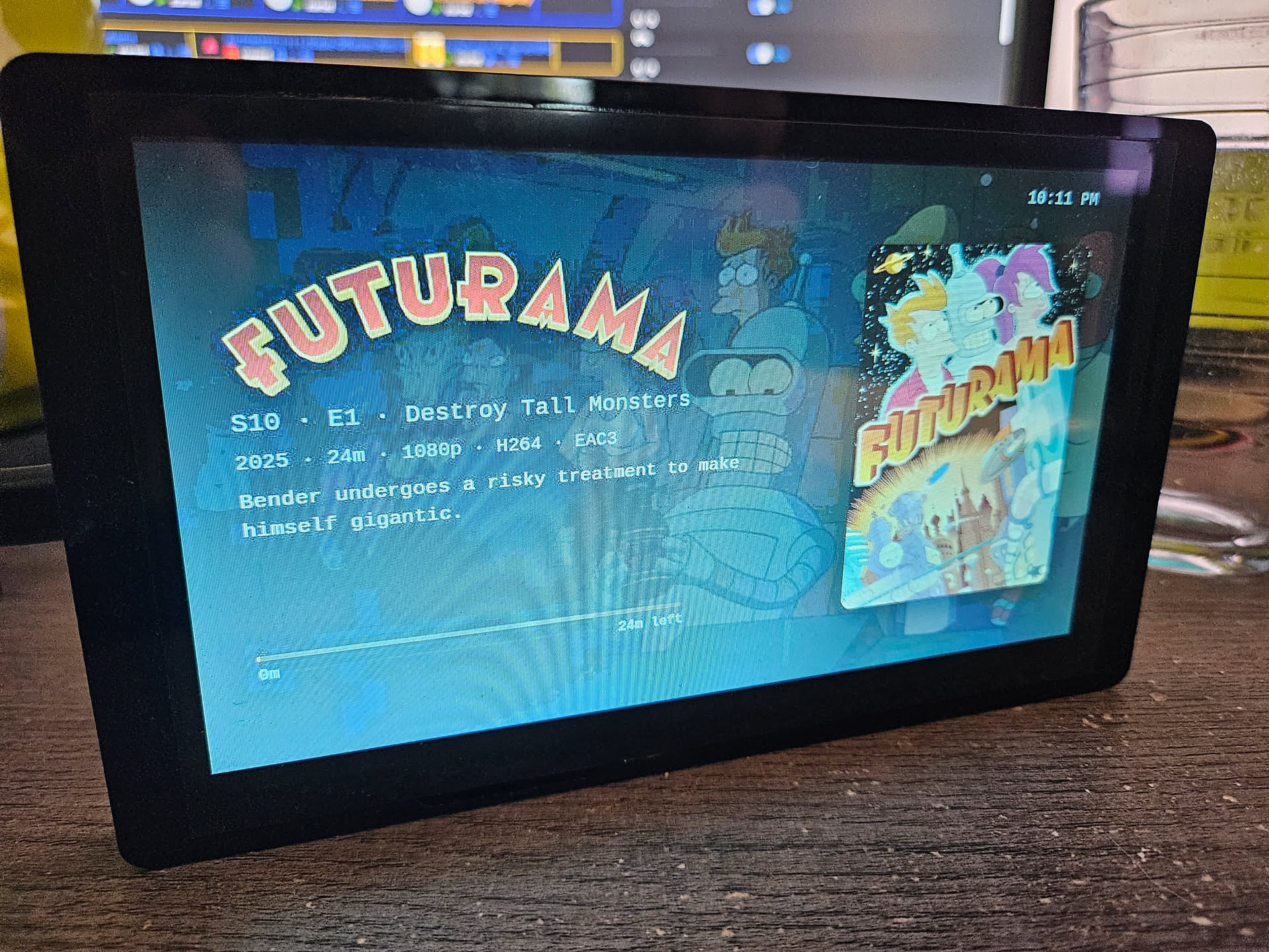

There’s a great little project called Marquee (by Jamisonfitz) that turns a Google Nest Hub into a gorgeous “now playing” display for Plex, Emby, or Jellyfin — poster, title, plot, ratings, progress bar, clock, the works.
For those who don’t own a Nest Hub, or are moving away from them, I wanted to expand the project to support ESP32 displays. I bought the first, most popular disoplay on Amazon compatible with ESPhome, a 7" Elecrow CrowPanel (an ESP32-S3 touch screen). So I taught it to show the exact same card, driven by ESPHome. No Nest Hub, no soldering, no custom firmware toolchain — just an ESPHome YAML you flash from the dashboard.
I want to share it so others can build one too. Spark some ideas for your own projects.

Happy to answer questions or help anyone getting a different panel working. If you build one, post a photo. ![]()
