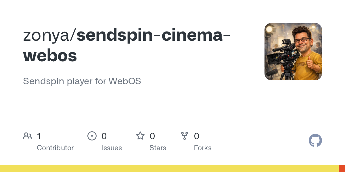

GitHub Repository: https://github.com/zonya/sendspin-cinema-webos

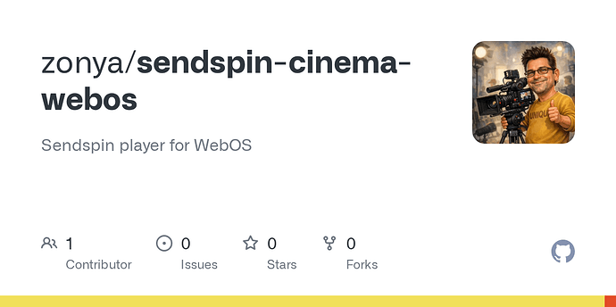

Thanks for pointing that out! The link got accidentally wrapped
in a Google search URL when I pasted it. Should be correct now:
GitHub - zonya/sendspin-cinema-webos: Sendspin player for WebOS · GitHub
