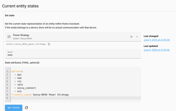

The sensor has the following options:

Find the entity in States under Developer Tools. Check the name - the current state and the valid states - they will be listed as options: followed by a comma separated list.

So I am feeling like an idiot right now for not noticing this before, but nom is one of the options of the select. Not one of the displayed options though. So the select looks like this:
Is there a way to get the Human readable state names (like the screenshot I posted before) and use them? Or should I do a remap with if’s in the esp code?
I just changed the lambda to display the correct string to below code, and it works!
Thanks again!
