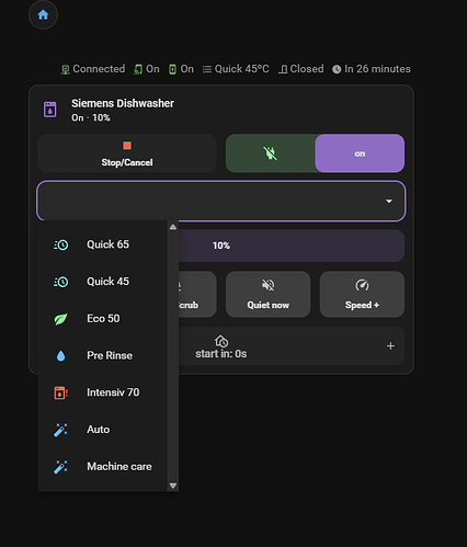

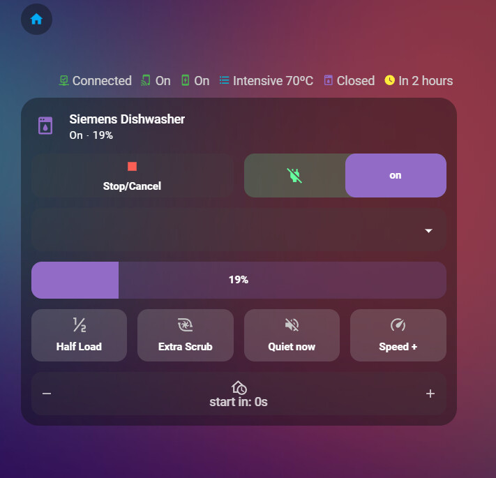

Hi guys!
I just managed to finally configure a custom card using custom-card-features (GitHub - Nerwyn/custom-card-features: Home Assistant custom features for tile cards and more. Call any action using buttons, dropdowns, inputs, selectors, sliders, spinboxes, and toggles.) for my Siemens Dishwasher. I really wanted to keep my mushroom dashboard look and the custom-card-features was just what I needed.
Here are some examples:
And here is the code:
features:
  - type: custom:service-call
    entries:
      - type: button
        entity_id: button.dishwasher_stop_program
        icon: mdi:stop
        haptics: false
        styles: |-
          .icon {
          color: #FA5F55;
        label: Stop/Cancel
        tap_action:
          action: toggle
          data: {}
      - type: toggle
        entity_id: switch.dishwasher_power
        tap_action:
          action: toggle
          data: {}
        checked_values:
          - "on"
        unchecked_icon: mdi:power
        checked_icon: mdi:power-plug-off
        icon: ""
        styles: |2
            .background {
              --color: {% if is_state(config.entity, 'on') %} #66FFA0 {% else %} #FF5F4D {% endif %};
            .icon {
        thumb: default
        value_attribute: State
        label: "{{ value }}"
    styles: |2-
            :host {
              --feature-height: 50px;
    entries:
      - type: dropdown
        entity_id: select.dishwasher_active_program
        options:
          - entity_id: select.dishwasher_active_program
            option: dishcare_dishwasher_program_quick_65
            tap_action:
              action: perform-action
              perform_action: select.select_option
            label: Quick 65
            icon: mdi:clock-fast
            styles: |-
              .icon{
              color: #00FFF2;
            option: dishcare_dishwasher_program_quick_45
            tap_action:
            label: Quick 45
            styles: |-
              .icon{
              color: #00FFF2;
            option: dishcare_dishwasher_program_eco_50
            tap_action:
            label: Eco 50
            icon: mdi:leaf
            styles: |-
              .icon{
              color: #29FF8F;
            option: dishcare_dishwasher_program_pre_rinse
            tap_action:
            label: Pre Rinse
            icon: mdi:water
            styles: |-
              .icon{
              color: #29C2FF;
            option: dishcare_dishwasher_program_intensiv_70
            tap_action:
            label: Intensiv 70
            icon: mdi:dishwasher-alert
            styles: |-
              .icon{
              color: #FF684D;
            option: dishcare_dishwasher_program_auto_2
            tap_action:
            label: Auto
            icon: mdi:auto-fix
            styles: |-
              .icon{
              color: #29C2FF;
            option: dishcare_dishwasher_program_machine_care
            tap_action:
            label: Machine care
            icon: mdi:auto-fix
            styles: |-
              .icon{
              color: #29C2FF;
        value_attribute: options
        autofill_entity_id: true
        haptics: false
        styles: |
          :host {
            flex-basis: 200%;
            height: 50px;
    entries:
      - type: slider
        entity_id: sensor.dishwasher_program_progress
        tap_action:
          data: {}
        range:
          - 0
          - 100
        label: "{{ value | float }}%"
        thumb: flat
    styles: ""
    entries:
      - type: button
        entity_id: switch.dishwasher_half_load
        hold_action:
          action: toggle
          data: {}
        label: Half Load
        icon: mdi:fraction-one-half
        styles: |2
            .background {
              --color: {% if is_state(config.entity, 'on') %} #66FFA0 {% else %} #C7C7C7 {% endif %};
            .icon {
      - type: button
        entity_id: switch.dishwasher_intensive_zone
        hold_action:
          action: toggle
          data: {}
        label: Extra Scrub
        icon: mdi:car-turbocharger
        styles: |2-
            .background {
            .icon {
      - type: button
        entity_id: switch.dishwasher_silence_on_demand
        label: Quiet now
        icon: mdi:volume-off
        styles: |2-
            .background {
            .icon {
      - type: button
        entity_id: switch.dishwasher_vario_speed
        hold_action:
          action: toggle
          data: {}
        label: Speed +
        icon: mdi:speedometer
        styles: |2-
            .background {
            .icon {
    styles: |2-
            :host {
              --feature-height: 60px;
    entries:
      - type: spinbox
        entity_id: number.dishwasher_start_in_relative
        tap_action:
            entity_id:
              - number.dishwasher_start_in_relative
          perform_action: number.set_value
            value: "{{ value }}"
        range:
          - 0
          - 100
        hold_action:
          action: repeat
        value_from_hass_delay: 86400
        unit_of_measurement: s
        label: "start in: {{ value }}{{ unit }}"
        icon: mdi:home-clock-outline
        value_attribute: min
        step: 1
    styles: |2-
            :host {
type: tile
show_entity_picture: false
vertical: false
layout_options:
  grid_columns: 4
  grid_rows: 2
features_position: bottom
color: purple
name: Siemens Dishwasher
hide_state: false
entity: switch.dishwasher_power
tap_action:
  action: none
icon_tap_action:
  action: none
card_mod:
  style:
    ha-tile-info$: |
      .secondary:after {
        visibility: visible;
        content: " ⸱ {{ states('sensor.dishwasher_program_progress') }}%";
It really took a lot of time to find out how to make this to work so if it helps someone do the job quicker, you’re welcome!

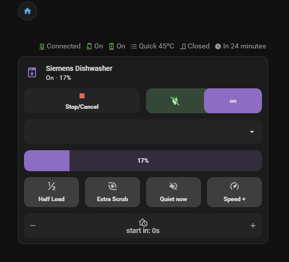

Another Screenshot with iOS background Theme:

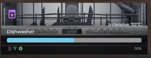

I forgot to share with you the static card, for showing the state of the Dishwasher on a dashboard:
type: vertical-stack
cards:
  - type: conditional
    conditions:
      - condition: state
        entity: sensor.dishwasher_operation_state
        state_not: run
    card:
      type: custom:button-card
      show_label: true
      tap_action:
        action: none
      hold_action:
        action: none
      double_tap_action:
        action: none
      card_mod:
        style: |
          ha-state-icon {
            {% if is_state('switch.dishwasher_power', 'on') %}
            animation: bounce 1.5s ease-in-out infinite, wash 1s ease-in-out infinite;
            {% else %}
            animation: none;
            {% endif %}
            transform-origin: 50% 75%;
            color: #c67aff !important;
          ha-card {
            position: relative !important;
            overflow: hidden !important;
            border-radius: 12px !important;
          /* Top header strip with image */
          ha-card::before {
            content: "";
            position: absolute;
            top: 0;
            left: 0;
            right: 0;
            height: 40px;
            background-image: url("/local/Media/dishwasher.png") !important;
            background-size: cover !important;
            background-position: center !important;
            border-bottom: 1px solid rgba(0,0,0,0.2) !important;
            z-index: 1;
            pointer-events: none;
          /* Full background image */
          :host::after {
            content: "";
            position: absolute;
            top: 0; left: 0; right: 0; bottom: 0;
            background-image: url("/local/Media/icons/dishwasher.png") !important;
            background-repeat: no-repeat !important;
            background-color: rgba(0, 0, 0, 0.3) !important;
            z-index: 0;
          @keyframes bounce {
            0%, 20%, 50%, 80%, 100% {transform: translateY(0);}
            40% { transform: translateY(-1.2px) rotate(5deg);}
            60% { transform: translateY(-1.1px) rotate(-4deg);}
          @keyframes wash {
            50%  { clip-path: polygon(0 0, 0 100%, 35% 100%, 36% 74%, 31% 43%, 61% 40%, 71% 69%, 62% 78%, 36% 73%, 35% 100%, 100% 100%, 100% 0); }
      styles:
        card:
          - padding: 20px
          - height: 180px
          - font-family: montserrat
        grid:
          - grid-template-areas: "\"i program\" \"n stat2\" \"bar bar\" \"stat1 stat3\""
          - grid-template-columns: 1fr 1fr
          - grid-template-rows: 70px min-content 40px min-content
        name:
          - justify-self: start
          - font-size: 16px
          - font-weight: 500
          - z-index: 2
        label:
          - font-size: 16px
          - font-weight: 500
          - z-index: 2
        icon:
          - width: 36px
          - z-index: 2
        img_cell:
          - align-self: start
          - width: 36px
          - height: 36px
        custom_fields:
          program:
            - justify-self: end
            - align-self: end
            - padding-bottom: 6px
            - font-size: 16px
            - font-weight: 500
            - z-index: 2
          stat1:
            - font-size: 12px
            - opacity: 0.7
            - z-index: 2
          stat2:
            - justify-self: end
            - font-size: 16px
            - font-weight: 500
            - z-index: 2
          stat3:
            - justify-self: end
            - font-size: 12px
            - opacity: 0.7
            - z-index: 2
          bar:
            - width: 100%
            - border-radius: 6px
            - background: var(--slider-color)
            - height: 16px
            - z-index: 2
      custom_fields:
        bar: |-
            var s = parseFloat(states['sensor.dishwasher_program_progress'].state);
            var val = isNaN(s) ? 0 : s;
            return `<div style="background: #949494; border-radius: 6px; width: 100%; height: 16px;"><div style="background: #34cfeb; border-radius: 6px; height: 16px; width: ${val}%;"></div></div>`;
        program: |-
            var pwr = states['switch.dishwasher_power'].state;
            var prg = states['select.dishwasher_active_program'].state;
            var map = {
              "dishcare_dishwasher_program_quick_65": {name: "Quick 65", color: "#00FFF2", icon: "mdi:clock-fast"},
              "dishcare_dishwasher_program_quick_45": {name: "Quick 45", color: "#00FFF2", icon: "mdi:clock-fast"},
              "dishcare_dishwasher_program_eco_50": {name: "Eco 50", color: "#29FF8F", icon: "mdi:leaf"},
              "dishcare_dishwasher_program_pre_rinse": {name: "Pre Rinse", color: "#29C2FF", icon: "mdi:water"},
              "dishcare_dishwasher_program_intensiv_70": {name: "Intensive 70", color: "#FF684D", icon: "mdi:dishwasher-alert"},
              "dishcare_dishwasher_program_auto_2": {name: "Auto", color: "#29C2FF", icon: "mdi:auto-fix"},
              "dishcare_dishwasher_program_machine_care": {name: "Machine Care", color: "#29C2FF", icon: "mdi:auto-fix"},
              "dishcare_dishwasher_program_night_wash": {name: "Silent", color: "#29C2FF", icon: "mdi:weather-night"}
            if (pwr === 'off') return "Off";
            var d = map[prg];
            if (d) return `<span style="color: ${d.color}; font-weight: 500;"><ha-icon icon="${d.icon}" style="width: 18px; height: 18px; vertical-align: middle; margin-right: 4px;"></ha-icon>${d.name}</span>`;
            return prg;
        stat1: |-
            var door = states['sensor.dishwasher_door'].state;
            var wifi = states['binary_sensor.dishwasher_remote_control'] ? states['binary_sensor.dishwasher_remote_control'].state : 'off';
            var play = states['binary_sensor.dishwasher_remote_start'] ? states['binary_sensor.dishwasher_remote_start'].state : 'off';
            var dCol = (door === 'Open') ? '#fc6656' : '#c0c4c4';
            var wCol = (wifi === 'on') ? '#34eb77' : 'gray';
            var pCol = (play === 'on') ? '#34eb77' : 'gray';
            return `<ha-icon icon="mdi:door-${door === 'Open' ? 'open' : 'closed'}" style="width: 16px; height: 16px; margin-right: 4px; color:${dCol};"></ha-icon><ha-icon icon="mdi:wifi" style="width: 16px; height: 16px; margin-right: 4px; color:${wCol};"></ha-icon><ha-icon icon="mdi:play-circle" style="width: 16px; height: 16px; color:${pCol};"></ha-icon>`;
        stat2: |-
            var f = states['sensor.dishwasher_program_finish_time'].state;
            if (!f || f === 'unavailable' || f === 'unknown') return "";
            var t = new Date(f);
            return 'Ends: ' + t.getHours() + ':' + (t.getMinutes() < 10 ? '0' : '') + t.getMinutes();
        stat3: |-
            var p = states['sensor.dishwasher_program_progress'].state;
            return (p === 'unavailable' || p === 'unknown' || p === '') ? "Ready" : p + '%';
