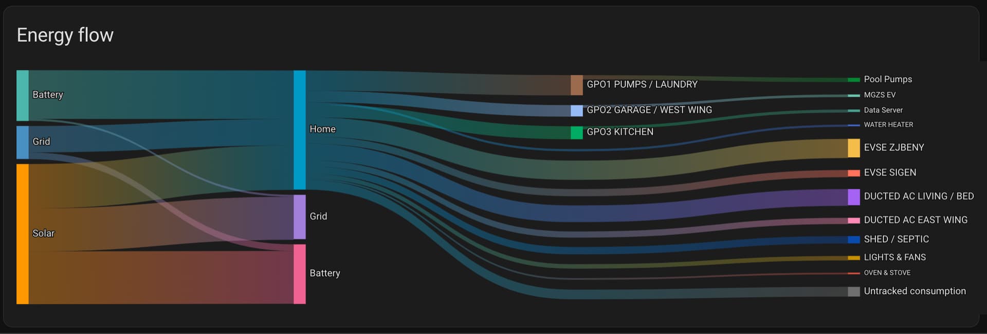

I have just had my sigenergy system installed and i’m getting started with using HA. I’ve had modbus enabled and can see all the entities coming through. I wanted to try and re-create the Sanke card from app - i can get the figures for each of the elements (pv, battery grid etc.) but I couldn;t see an entity or a way to try and calculate what percentage is going where. i.e how much of the pv is going to battery, grid or load or how much grid import is going to battery, load. Has anyone managed to reproduce the Sanke diagran like the app?
Also i have seen a few github pages from people who managed to recreate the house with all the value but i couldn’t get that working at all. Not sure if its because it still in dev or if anyone has a yaml i can use to reproduce it.
I configured the energy tab too but again not sure if i did it right! so any help on which entities i should be setting up on that would also be really appreciated
Any help or screenshots of how people are using HA to show the Sig kit would be really appreciated!
There is already a Sankey chart included with the Energy Dashboard.
Oh really - there isn’t one in mine… i’ll see if there is a setting i’m missing maybe
It was introduced in the 2025.8 version of HA Core. Are you up to date?
You can also install one on your own dashboard:
