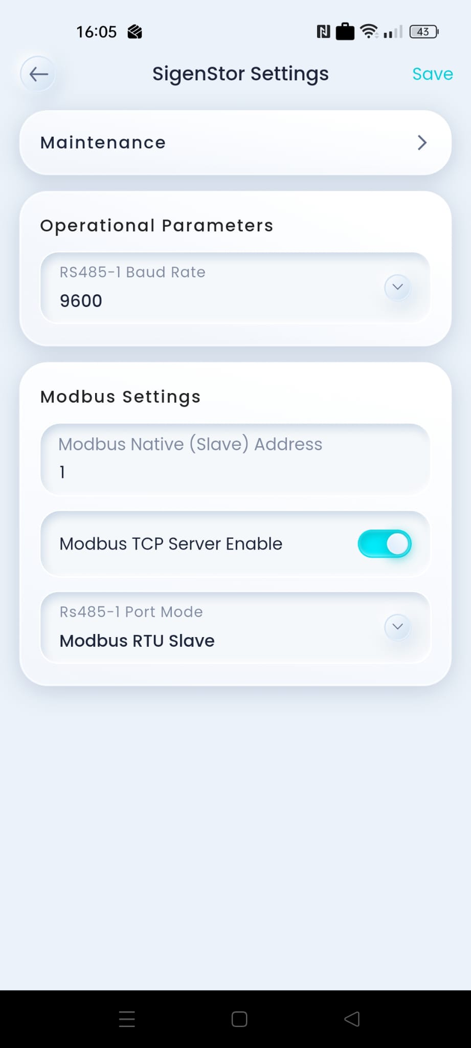

Sorry if this has been answered before. I am getting this when I try to add my AC Charger to HA
Modbus exception during read for register 32000 on 192.168.50.89: Modbus Error: [Input/Output] No response received after 3 retries, continue with next request
I had my charger replaced as the original which I added successfully was tethered. That was replaced and I removed it from HA and now trying to re-add, it is giving me the above error.
I have the charger as ID=1 and Inverter as ID=2. The inverter is added fine
Can you please share a link or tell me how to enable ModBus?
You need to request either your installer or Sigenergy to activate it. It’s not something a user can enable.

A note for those having trouble connecting to Modbus. I have the latest version of the HA software. I don’t have HACS installed. I can only connect to Sigenergy via Wi-Fi. The IP address entered in secrets.yaml is the one Sigenergy uses to connect to my Wi-Fi. The installer provided the image below. I have access to Sigenergy sensors.
I have been in contact with Sigenergy about the ugly broadcasts. Basically crippled my network. I had to spend to get unifi gateway and switches to isolate the traffic and this fixed the issue.
To cut the story short, Sigenergy refused to acknowledge there is an issue. They said these broadcasts are necessary for their system to work and basically told me there is nothing they can do or will do.
