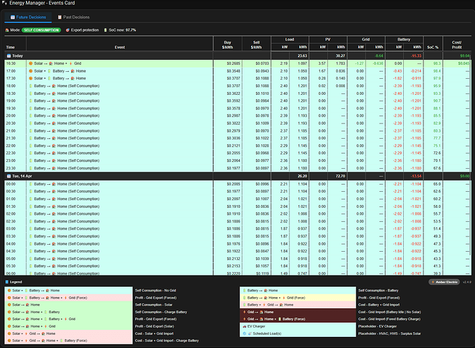

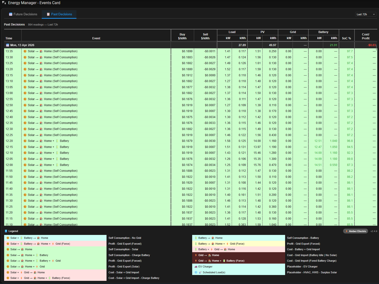

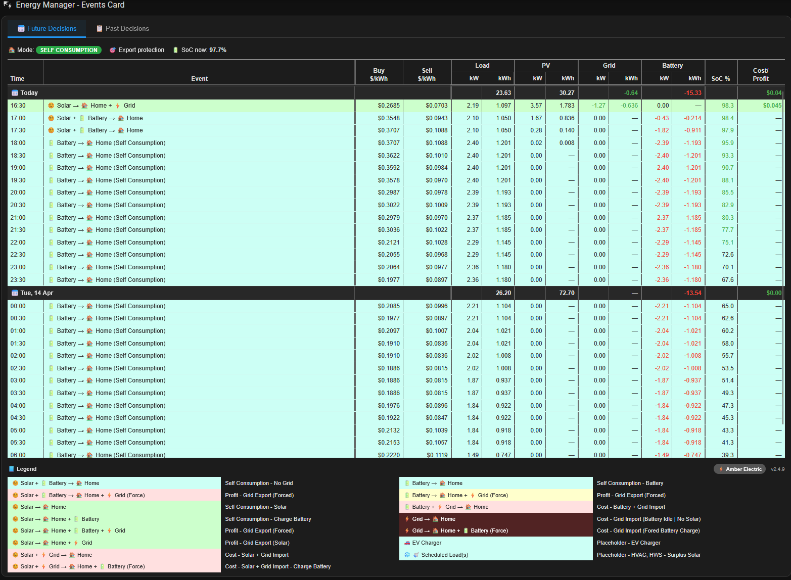

Curerntly being worked upon, but if your a Home Assistant Energy Optimiser (HAEO), EHMASS (still ironing some bugs / working around its lack of some sensors) or Energy Manager (www.energymanager.com.au) user, for automating your SigEnergy then also worth looking at, with work to get these tables working with Genergy Dashboard.
Future Decisions
Past Events (reads from the SIG TypQxQ sensors history by default, but there’s options to override the sensors used in card yaml, for non-SIG users).
HAEO / EMHASS versions are similar, just depending upon the sensors / data they make available.
PS. Boring example days… not much buy/sell going on today. ![]()
