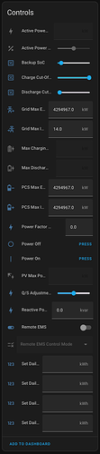

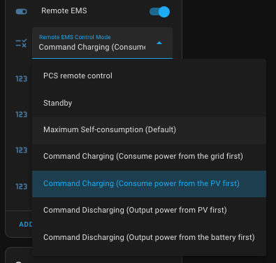

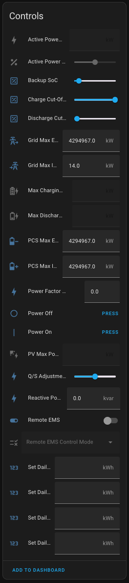

You can control the:
  • charge and discharge modes, there are several (see remote EMS mode options shown below)
  • maximum import and export power from/to the grid
  • maximum rate of battery charge or discharge
  • maximum PV output
  • battery reserve SOC
  • maximum charge SOC
  • minimum discharge SOC
  • system on and off
But do note that these are also controllable with the Sigen app (mobile app or browser) and it also has various options for time based control, custom modes, operating with their AI etc. For most people the Sigen native app will perform most of what they are likely to need.
As for working with your other PV inverters, that’s a matter of set up by the installer and wiring with the gateway. AC coupled solar PV can be separately monitored via the gateway and the system manages charging accordingly and any power company export limits.
Controls:
Remote EMS Mode options:

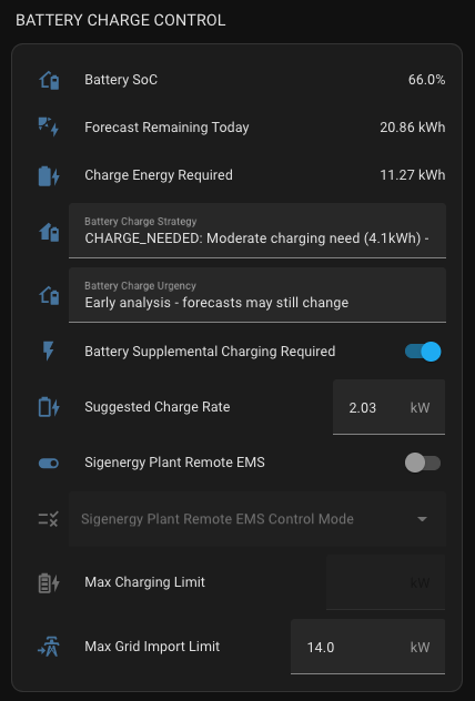

I’m now working on some controls for my Sig system.
My want is pretty simple. We have a free grid energy period each day 12-2 PM, so all I want it to do is ensure it gets enough supplemental charge during that period such that it will be fully charged by end of the day. Else it can run in default Self-consumption mode.
I could use the Sigen Time Based Control mode, however when using the grid charging option it either charges at the max rate set, or I need to manually adjust it to slow down because it does not need to charge quite so hard. I would rather the system only charged as fast as was required - it’s easier on the battery.
Some days, like yesterday, it did not require any supplemental charge, so it can remain in Self-consumption mode and the battery will fill up from solar (or already has).
But on rainy/cloudy days, especially if we’ve been using the ducted aircon for heating/cooling then we will require supplemental charging.
So I have used an AI to assist me build a Node Red flow which populates HA sensors which will continually update (every minute) whether supplemental charge is required, and the recommended charge rate to set for the battery.
I have this sort of output being generated:
I am yet to build the actual control automation, but that should be pretty straightforward. Switch on/off Remote EMS mode as required, select Command Charging (Consume power from the PV first), and set the desired battery charging rate. The way the Sig system works is when Remote EMS is disabled it defaults Self-consumption mode, which is what I want it to do.
