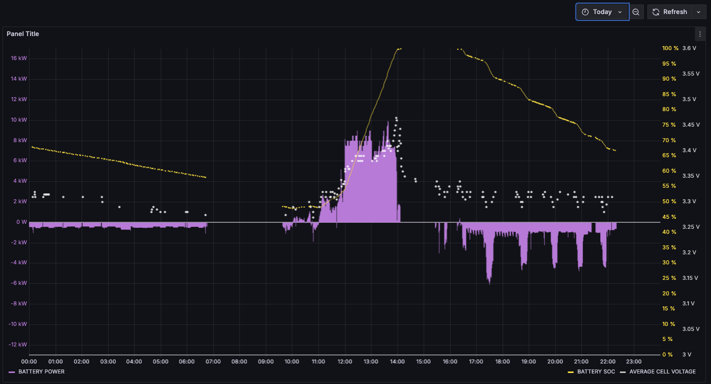

I have my control automation working now, it’s doing a good job of managing the battery charging during the grid free energy period.
Just charging at the right rate rather than going too fast or too slow to ensure the battery is filled up by the end of the day. This was today:
We are in a period of inclement weather so supplemental charging from the grid is going to be needed. The Sigen TBC mode wasn’t smart enough to automatically adjust the charge rate, while AI mode just did weird stuff.

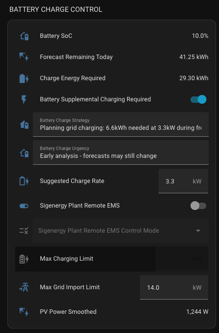

Apologies if this is a silly question but how do you change the charge rate from home assistant?
The Sigenergy system needs to be in Remote EMS mode for this to take effect. The operating mode is then controllable via the integration.
Which mode is used depends on what you want the system to do.
Then in my Sigenergy integration I have a sensor which sets the maximum rate at which the battery charges:
number.sigen_0_plant_max_charging_limit
I can adjust it manually or with an automation like any other control in HA.
So when my automation is controlling the charging, it puts the Sigenergy system into Remote EMS mode, in my case I use Command Charging (Consume power from PV first) and then begin adjusting the battery maximum charge rate.
Or I can even do it from a dashboard manually if I wish:
Thank you for your help. I have set Remote EMS mode using Command Charging (PV First) and this is working ok. I was having trouble locating max charging limit setting. I found I have a number.sigen_plant_ess_max_charging_limit which has a value of 0 kw. Is this the correct one? At the moment it is disabled. Is it just a case of enabling this individual entity within settings and setting it to the required value?
Thanks again.
The name of the entity may be slightly different in different integrations but that sounds like the one.
It is not available to adjust unless Remote EMS mode is activated.
Just be aware that if you do activate Remote EMS mode, and then deactivate it, the Sigenergy system will then default to Max Self Consumption mode, it will not for instance revert back to another mode (e.g. Time Based Control) if that’s how it was operating before switching on Remote EMS.
This entity was still unavailable even after activating Remote EMS mode which is why I wanted to double check I’d got the right one before messing with it. I assume changing this value will limit charging from solar as well as from the grid? Do you know if there is a way to just limit grid charging?
Thanks for all your help.
You may need to check with the integration developer, mine certainly activates. Check that the entity is enabled.
It will limit the charge rate to the battery irrespective of the source of that power. How it does that likely depends on the Remote EMS Control Mode selected.

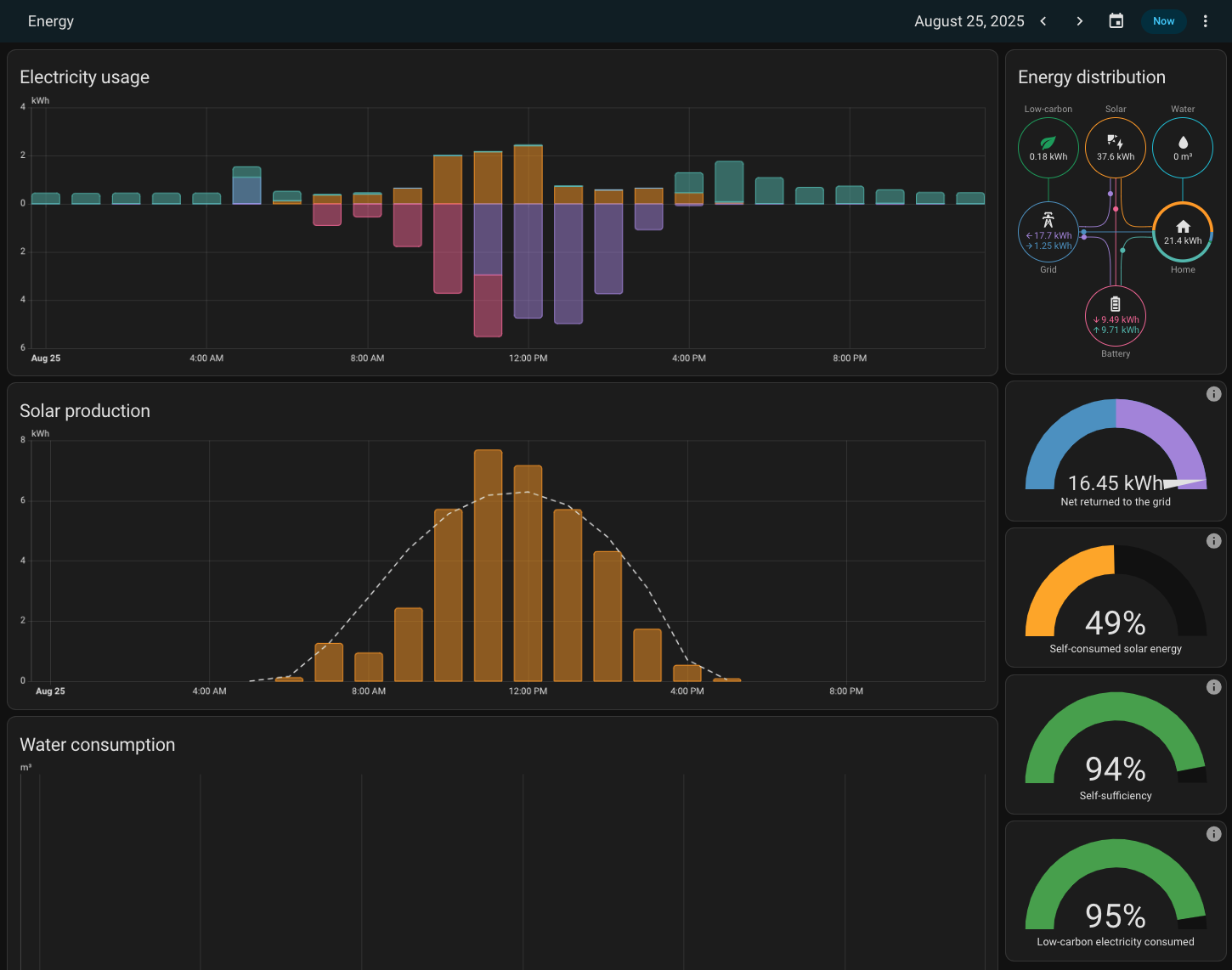

Does anybody know, which entity do I use to monitor the self consumption of the Sigenergy plant/inverter?
It might be sensor.sigen_accumulated_energy_consumption or sensor.sigen_daily_energy_consumption
Do you mean self-consumption of the inverter etc, or self-consumption of solar PV by the home?
If you mean the former, I’m not sure there’s an easy way to reliably determine that.
If you mean the latter it’ll be either:
PV Production - Grid Export
You’d need to set up your own custom template sensor to calculate it.
The Energy Dashboard already does it for you, showing a self consumption percentage in the right side panel of gauges:

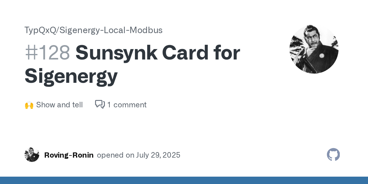

If anyone is interested in Sunsynk card for use with Sigenergy, there’s a mapping of sensors example here. I’m waiting for a change to be merged into the next release of the card, to add support for the operating/status etc registers so that a fault on the SIG will also bring up the warning light/ball on the card and a few other small things. Please test and give any feedback.
