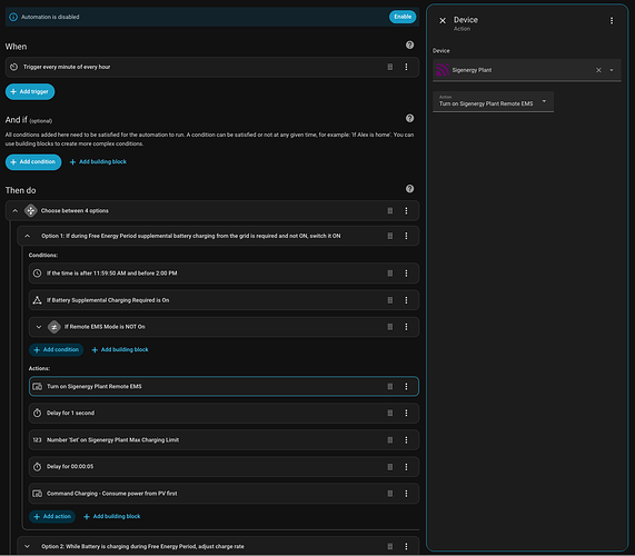

You can set it with the Action using the automation UI:
And in context:
Thanks a lot! That was just what I needed to get it working!!
How necessary are the delays in between entering commands? Did you just find that they are needed by trial and error?
They may not be necessary, it’s just I wanted to ensure the Sigenergy system had the time to enact the command before stuffing another down its throat.

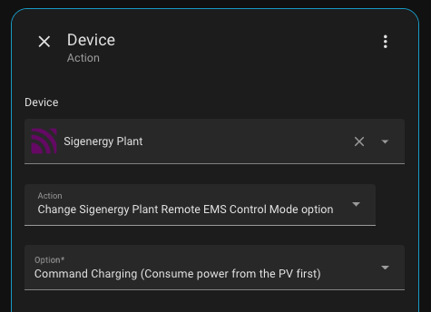

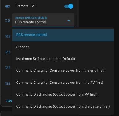

Thanks to wattmatters, I have made some good progress with HA running the Remote EMS mode. I have been testing each of the different Control Modes - there does not seem to be any comprehensive documentation about what each one does.
What is PCS Remote Control?
And what control items can be used with it?
Indeed that information is rather lacking and we are left with self-discovery.
I’ve only use Command charging (Consume power from the PV first) option so far - it’s used in an automation to ensure my battery gets fully charged during our free grid energy period. I have no need at this time for the other options.

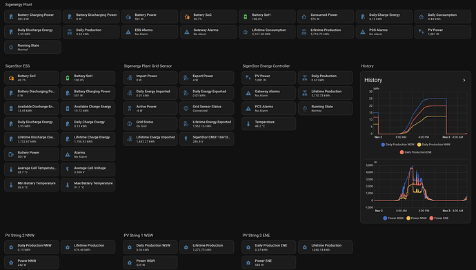

The first thing it provides is a plethora of data about the system. So you can design dashboards and construct automations using such data as inputs.
I’ve not bothered to make a flashy dashboard but this gives some idea of the data available (mine is a single phase system):

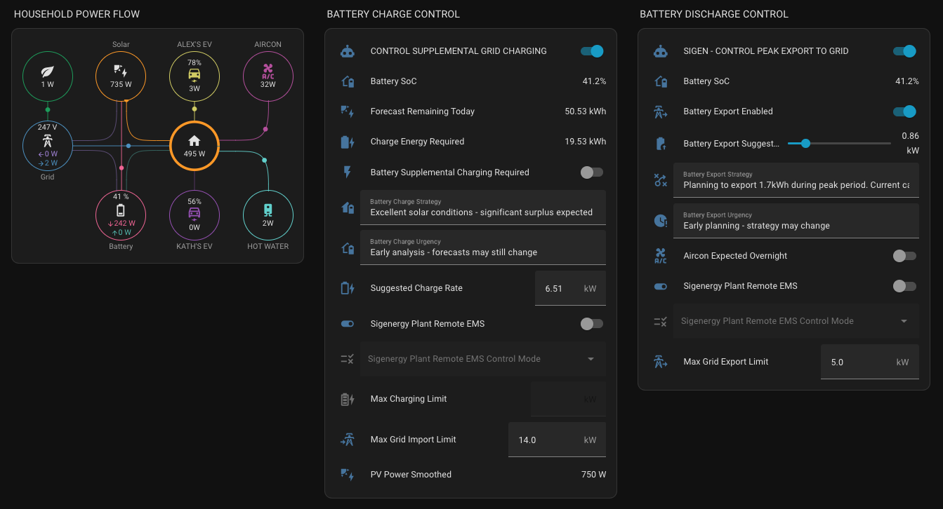

I have set up my own automations to manage:
  • supplemental charging of the battery using free grid energy if the solar PV on any given day is insufficient
  • discharge the battery to the grid during peak period for special bonus credit and import avoidance bonus (in total worth $2.50 for exporting 10 kWh). It will only do this if there is sufficient battery capacity to spare (and that involves a projection of demand for the night ahead).
I can monitor them with a couple of simple dashboard panels:
The above is also doable just using the MySigen app except that I found the charging rate was a bit fixed/hard so I decided to roll my own so as to charge the battery only as fast as necessary, no more.
