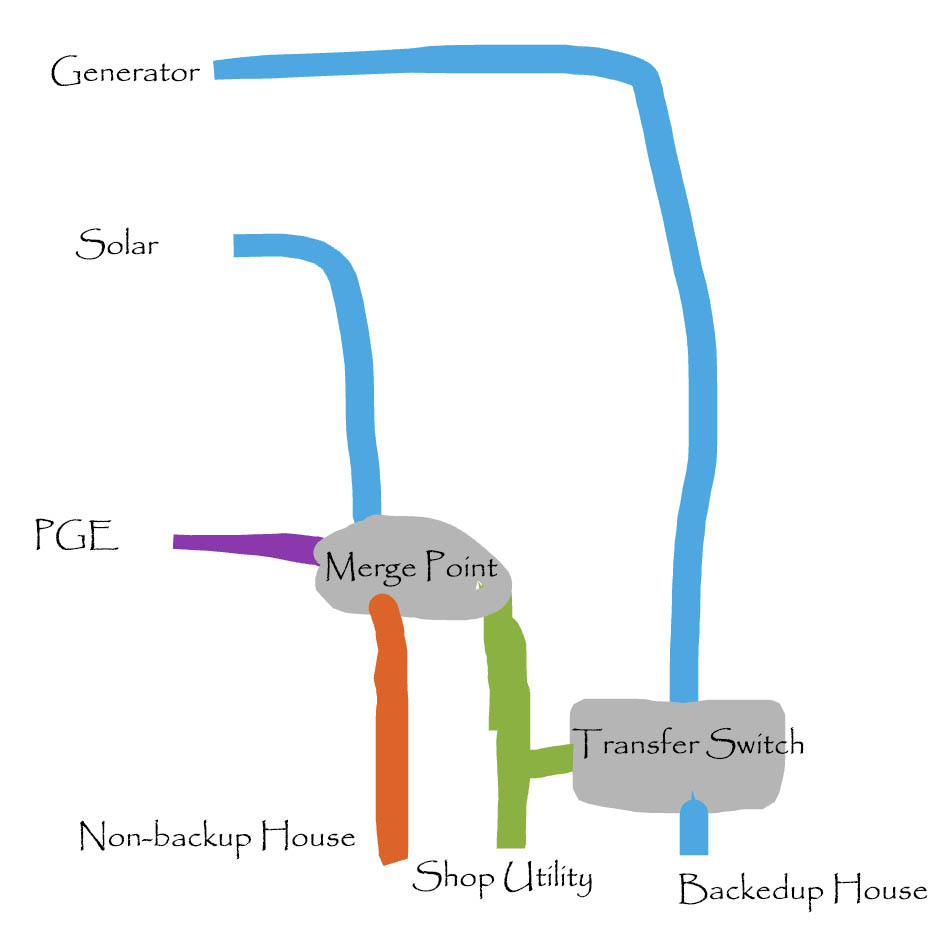

This is what my system looks like. I have PGE coming in to a single point mix; Solar and PGE mix (can not seem to monitor PGE separately, , it’s only about 1/2" tabs into the backplane in the input panel). I can monitor the solar input, as those were added in. So I have two inputs, going into a merged point. From there, I have two outputs. One is the main to the house, covering all the power hungry things that don’t use the backup generator (oven, dryer, jacuzzi, etc). Then there is the other output that powers both the shop utility panel (which is not backed up), and feeds the transfer switch between the generator and the backed-up portion of the house.
I have a vue3 on the shop utility panel, with power being taken from the backed-up circuit side of the transfer switch. This ensures that it operates when on generator. Hmm.. Just realized that the power to the router in the shop may not be on the generator.. sigh. Oh well, next fix.
I have a vue3 on the non-backed-up panel at the house, with 15 circuits monitoring all those devices. I have a vue3 on the backed-up sub panel at the house, with 16 circuits monitoring all of those devices.
On the shop vue3, I’ve got PhaseA/B plugged in on the non-backed-up house feed output, after the merge point. I also have a couple of the smaller sensors watching the shop-utility feed. It’s 60amps, so it’s within range of the smaller units. I also have two smaller sensors on the solar inputs to the merge.
On the backed-up panel vue3 at the house, I have phaseA/B plugged in on the inputs from the transfer switch. On the non-backed-up panel at the house, I do not have PhaseA/B plugged in. I figured they were covered from the shop A/B sensors.
Any help getting this to be something readable would be great, and very appreciated!
The only thing I can think of (so far) is to subtract the power from solar from the other two circuits to get the PGE values… if that makes any sense. Haven’t tried it yet..
