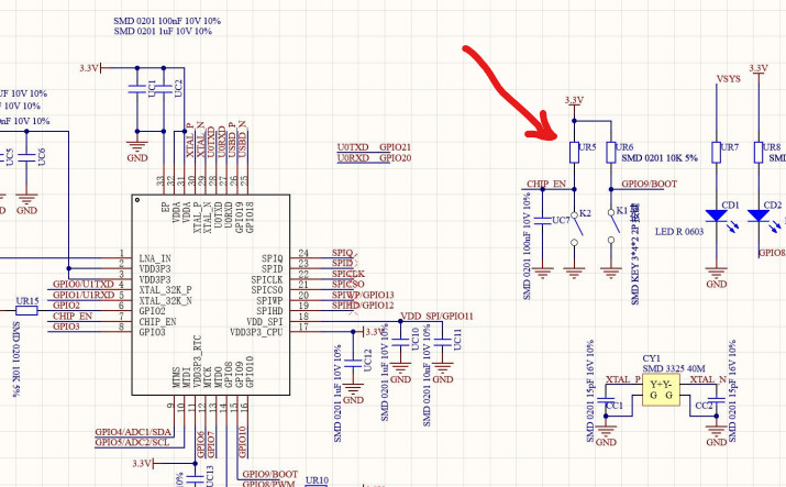

I see pullup on EN next to reset button on schematics though.
I missed that. You are probably right that it is dead. I would probably check that the reset button is not shorted and that the EN pin is high. If those are fine, I would declare it dead.
