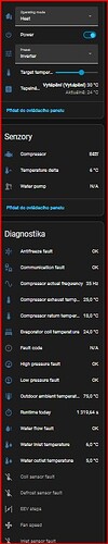

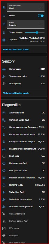

The behavior confirms a working v3.5 handshake, but DP-to-entity mapping needs adjustment (incorrect sensor/temperature values).

The wrong readings are expected. Your Full Inverter 70 exposes DPs 101–145, but the integration's 101–111 map currently comes from a different model (the JetLine Selection FI). So those diagnostic sensors read the right DP numbers but the wrong meaning for your firmware — e.g. it labels whatever your DP 101 is as "exhaust temperature."
The core climate values (power/mode/set/current temp on DPs 1–4) should be correct. Could you confirm whether the set and current water temperature in HA match the OEM app? If they read ~10× too high (e.g. 280 instead of 28), there's also a scaling difference to handle.

Note: DP 107 is absent from your firmware entirely — the JetLine FI has it as target frequency, your device doesn't use it.
My best guesses for the rest — please cross-check with the OEM app:
  • DP 108 = 35 → actual compressor frequency (Hz)?
    • DP 142 = 40 → target compressor frequency (Hz)?
    • DP 104 = 67 → outdoor humidity (%)?
    • DP 114 = 781 → power consumption (W)?
    • DP 120 = 230 → AC voltage (V) — looks very much like mains voltage
    • DP 121 = 4 → current draw (A)?
    • DP 124 = 45 → discharge gas temperature (°C)?
    • DP 110 = 85 → fan speed (% or RPM)?
    • DP 111 = 267 → water pump speed (RPM)?
      Could you check the OEM app while the pump is running and tell me what values it shows for frequency, humidity, power, and anything else — so I can pin down the unknowns?
Once confirmed I'll add a proper Full Inverter 70 profile so those diagnostic sensors all read correctly.
