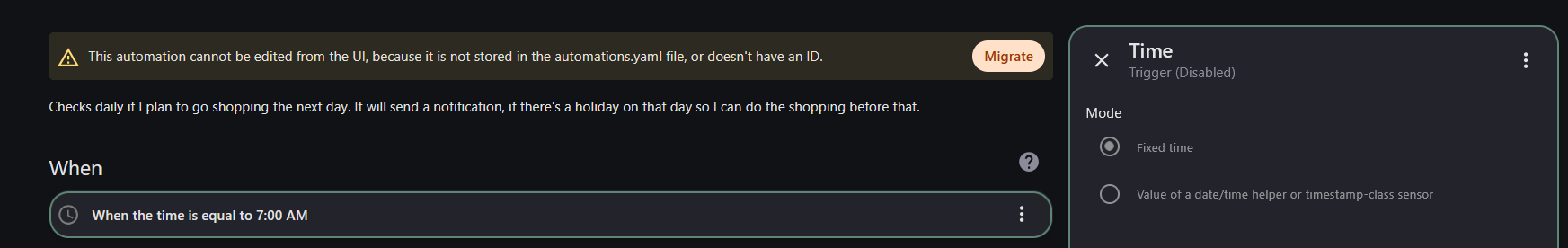

In the UI it shows “disabled” when I click on the trigger which might be a visual bug but still suspicious:
I’ve tried various things like different triggers or stripping the automation down but nothing worked so far. No logs are written for this. Copying the automation into the UI, the trigger is not marked disabled but I haven’t tested if it triggers that way.

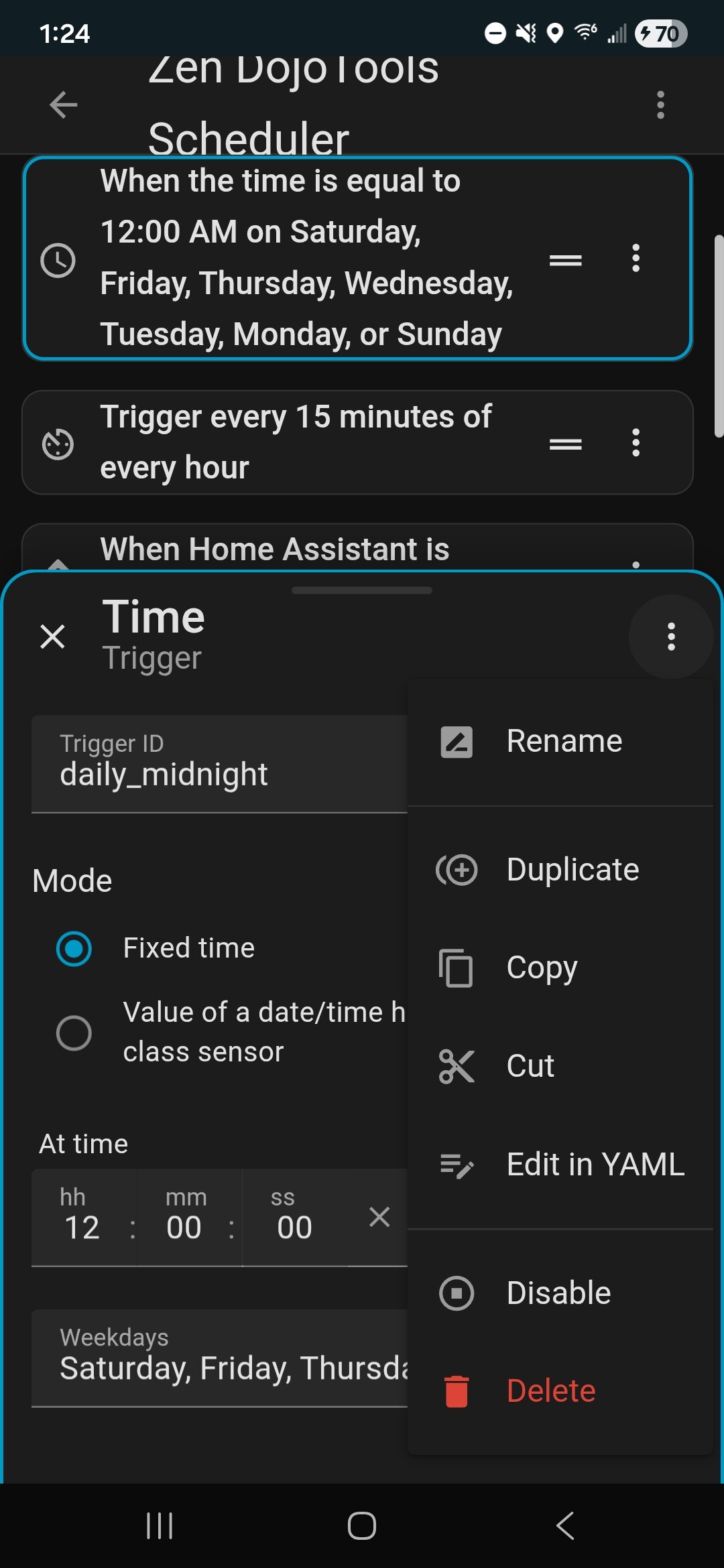

Nope, that trigger is legit disabled if it says that and won’t fire.
Click on the disabled trigger then in the edit window hit the three dot drop down and re-enable it. In my case it says disable because the trigger is enabled.

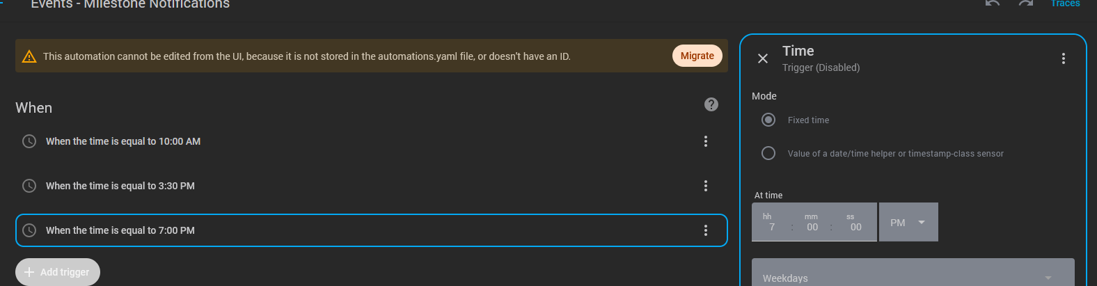

Ok ok ok, this seems to be a bug in the UI, the trigger is not disabled but the UI says it is
Here is my automation that I know is working because I got a notification yesterday.
So the bug is:
If you include an automation via True yaml only, then all triggers show disabled. I confirmed this by just going through all my automations, they all show every trigger as disabled.
