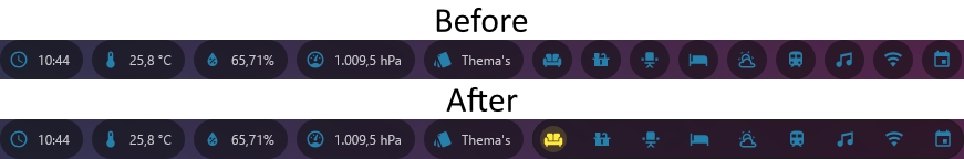

A custom Home Assistant badge that packs an entire row of navigation shortcuts into one single badge—instead of requiring a separate shortcut badge for every destination. The badge that matches your current view highlights automatically.
Built because copying mutliple individual shortcut badges into the configuration of every single view gets old fast. This card reduces simplifies the configuration.
Key Features
  • Space-saving: Condenses multiple navigation steps into one badge line.
  • Auto-highlighting: Dynamically detects and marks the active view.
  • HACS Ready: Easily installable as a custom repository.

I wanted a navigation bar, no separate shorcuts.
When adding a new view, just edit the navigationbar and copy paste it the new view.

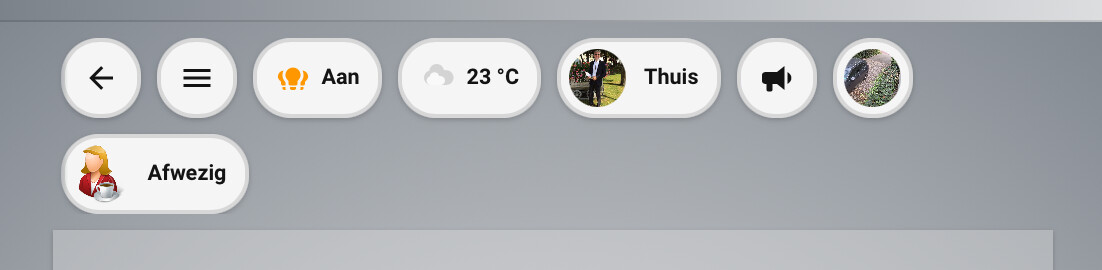

it is what the card is designed for..
badges:
  - type: custom:mushroom-chips-card
    chips:
      - type: back
      - type: menu
      - type: light
        entity: light.bureau_marijn_lampen
      - type: weather
        entity: weather.knmi
        show_temperature: true
        show_conditions: false
      - type: entity
        entity: person.marijn
        use_entity_picture: true
      - type: action
        tap_action:
          action: perform-action
          perform_action: script.say_next_alarm_greet
          target: {}
        icon: mdi:bullhorn
      - type: entity
        entity: camera.oprit
        content_info: none
      - type: entity
        entity: binary_sensor.gasten
not sure about dedicated navigation chips (not a big mushroom user here) but I use back and menu in those so navigation badges wont be an issue I figure
