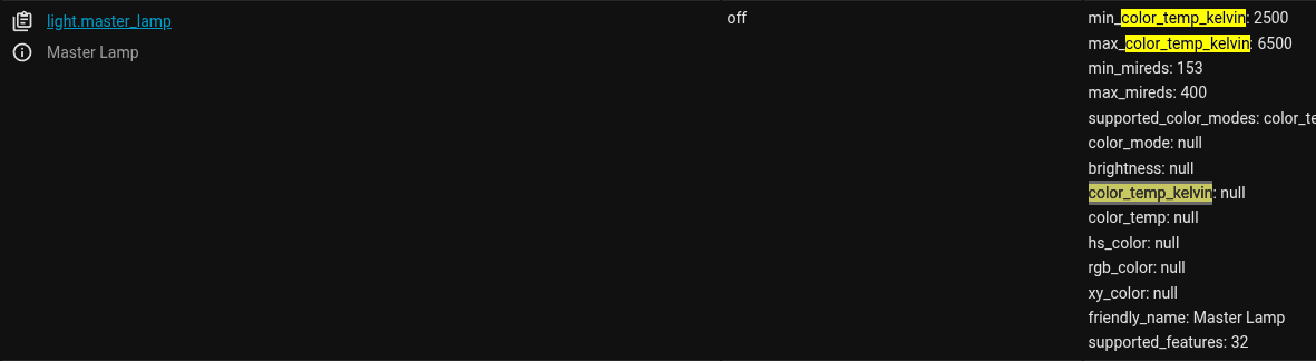

@chris400 does your light support color_temp_kelvin? You can see this in the developer tools menu on the state tab.
Yes, it does. It’s a hue, using the official bridge and integration.

It does actually change the color and brightness while running the automation. But it does start with an way to high brightness

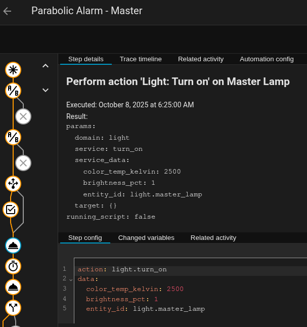

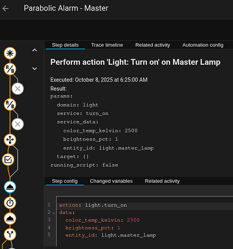

Unfortunately, I don’t have a Hue bridge/bulb to test with. Have you looked at the trace for the automation created by the blueprint?
When developing, I also created a template sensor to verify it was doing what I thought it was supposed to be doing. This allowed me to create a history graph of the brightness attribute and view as a percentage.

I have created a template sensor and will analyse the trace.
