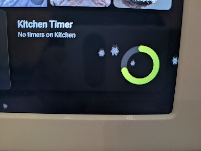

Since the AMP issues a few weeks ago, my timer cards show the countdown animation but the text shows “No Timers” set. Any deas?

Hi @NobbyJ69,
Jumping in to confirm what @eyalgal said, that screenshot looks like it is actually from my project, the TimeFlow Card.
Since this isn’t the right thread for it, please open a ticket on my repository so I can help you fix that error: Time-Flow Card
