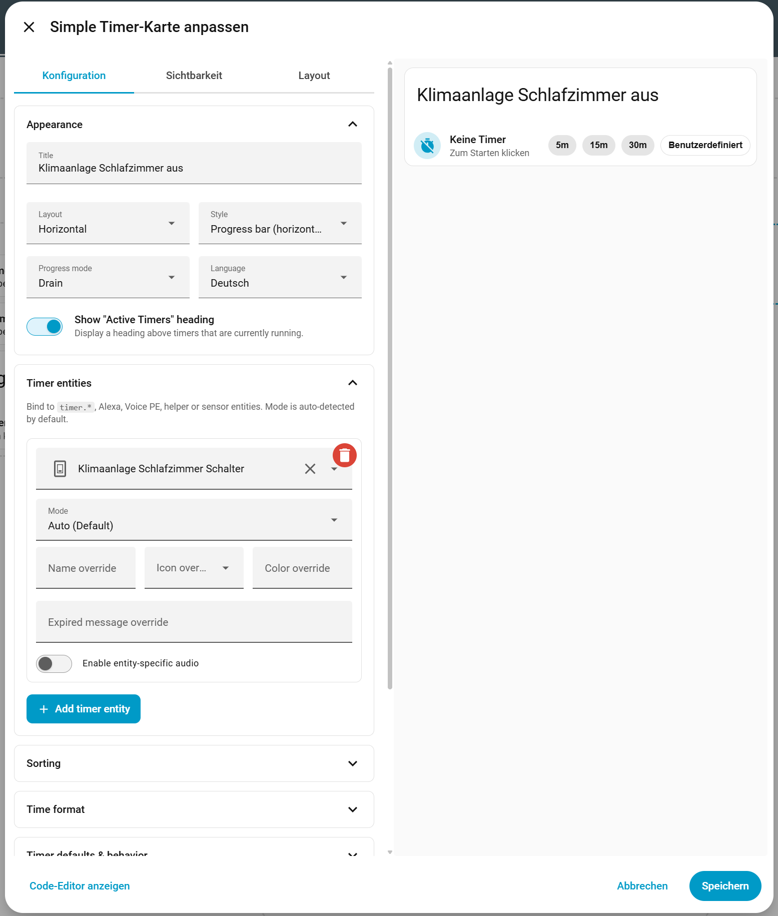

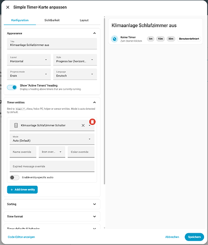

Hi, Does anyone have experience with this? There is a good YT video about it, but apparently something has changed:
Goal: I want to create a dashboard with buttons and various timers to control my air conditioning. However, the AC doesn't have a switch entity, so I need a workaround, because Simple Timer can only trigger switches.
What I've done so far: Created a helper switch (Boolean)
Linked the Simple Timer to the switch
Created a dashboard with the Simple Timer Card
But something isn't right yet. When I save the dashboard and start a timer, shouldn't the helper switch toggle its state? I want to use that state change as a trigger in an automation to turn off the air conditioning.
Any Ideas?
Hi @Zahackn, quick clarification: the "Simple Timer" HACS integration and this "Simple Timer Card" are two unrelated projects that happen to have similar names. The integration you're using needs a switch entity because that's how it works internally. My card has nothing to do with that mechanism, it doesn't toggle switches when a timer runs or expires, so the boolean staying off is expected behavior on the card's side.
For your actual goal (start a timer from a dashboard, have something happen when it ends, in your case turn off the AC), you don't need the Simple Timer integration or the helper switch at all. The card works with Home Assistant's built-in timer helpers. Here's the simpler setup:
1. Create a timer helper
Settings > Devices & services > Helpers > Create helper > Timer. Call it e.g. timer.ac_off. Leave duration blank so it can be set from the dashboard.
2. Add it to the card
type: custom:simple-timer-card
entities:
  - entity: timer.ac_off
timer_presets: [15, 30, 60, 120]
Starting a timer from the card calls timer.start with your chosen duration. No switch involved.
3. Automation to turn off the AC when the timer ends
automation:
  - alias: "AC off when timer ends"
    trigger:
      - platform: event
        event_type: timer.finished
        event_data:
          entity_id: timer.ac_off
    action:
      - service: climate.turn_off
          entity_id: climate.your_ac
That's the whole loop: tap a preset on the card -> timer counts down -> timer fires the timer.finished event -> automation turns the AC off. You can delete the helper switch entirely.
If you'd like to keep the boolean as a "AC scheduled off" status flag for other UI purposes, you can set it in the same automation, but it isn't required for the timer/AC flow itself.
