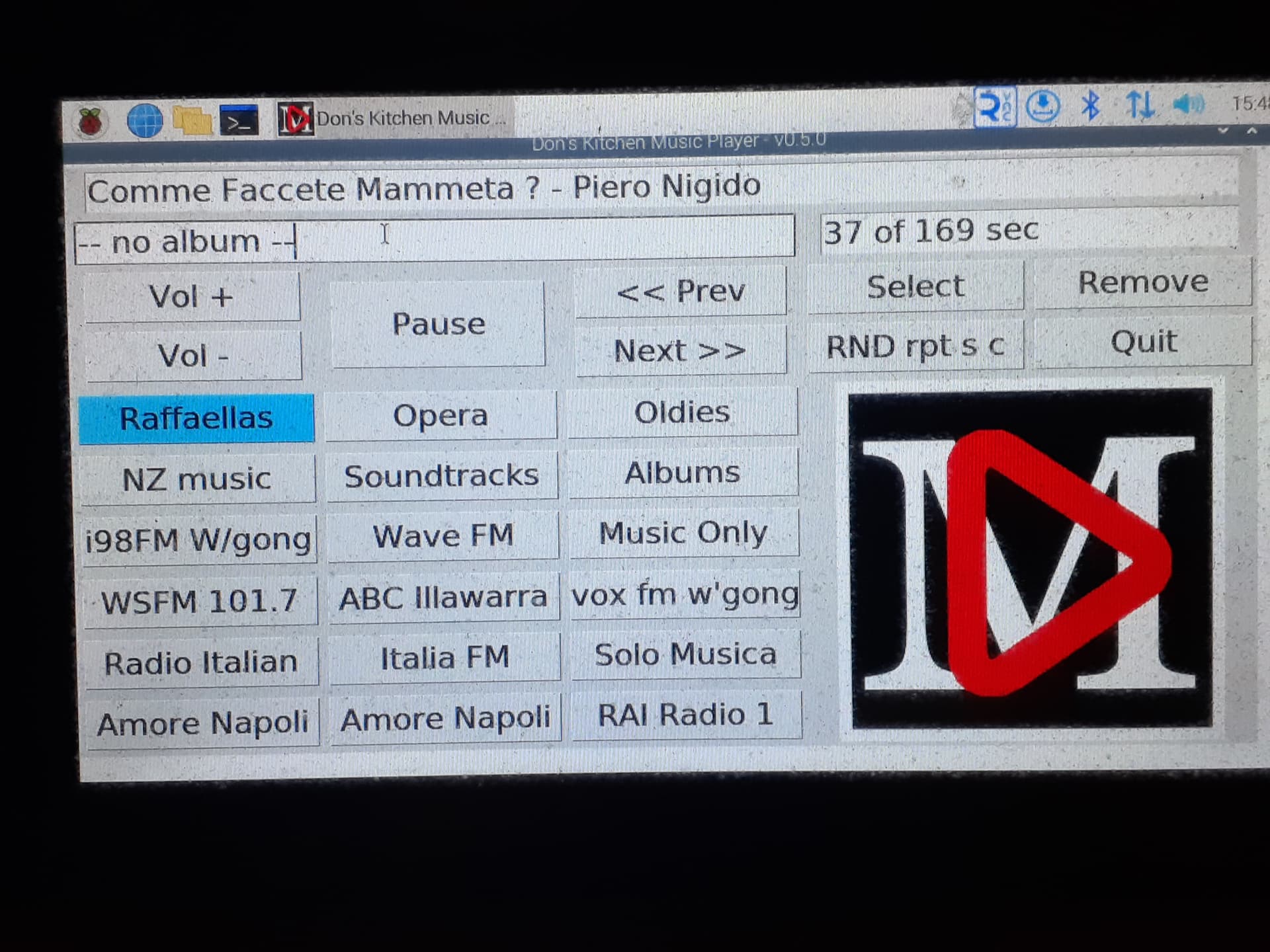

I'm after a device running Music Assistant and Voice Assist ... but for my 75 year old mum it needs a simple user interface, probably with a dozen radio buttons for playlists and radio stations, suitable for playing music in the background as she's cooking.
All the music players I found a few years ago seem designed for audiophiles who want all the bells and whistles as they select each track individually :frowning:
Is this even possible with MA ? Can you point me in the right direction or suggest appropriate keywords to search for ?
FYI, this is the python program I wrote a few years ago as a front end to mpd and running on a RasPi. My other option is to try adding Linux Voice Assist to this.

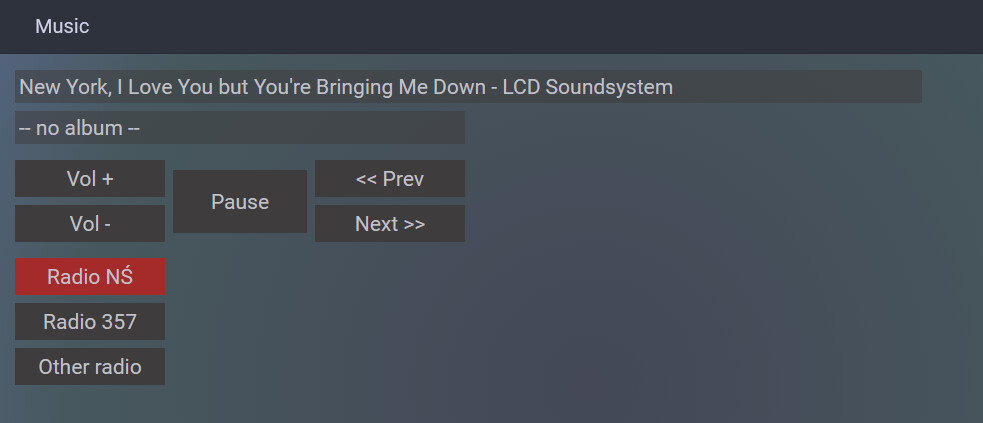

I'm using LMS instead of MA, so I don't know the details of MA, but basic control can be achieved using media_player services. Since you're no stranger to programming, you could create the UI yourself, for example, using custom:button-card. Basic JavaScript and CSS knowledge will be sufficient.
If you'd like to try it, to get you started, here's a dashboard/view in single-card mode that mimics part of your program:
Code

Colors come from my theme; you have full control over colors, font sizes, etc.; you can embed helpers/selectors (e.g. through entities card); you can enhance/declutter the code with custom button templates.
Thanks slimak, I haven't used custom:button-card before, but it does look like what I'm after, and it's been quite a while since I've done much website development - so I have some work ahead :wink: Thank you also for such a large chunk of code to get me started ... most appreciated.
So, if I understand correctly, the idea is to install Linux Voice Assist and a browser (to run full-screen in kiosk mode) on the Kitchen RasPi, with the browser configured to log into HA as a user who only sees the Music panel.
Ha! If you have experience with web development, UI should be easy. For me, the hardest part is always tackling CSS :slight_smile: Ask if you have any problems.
