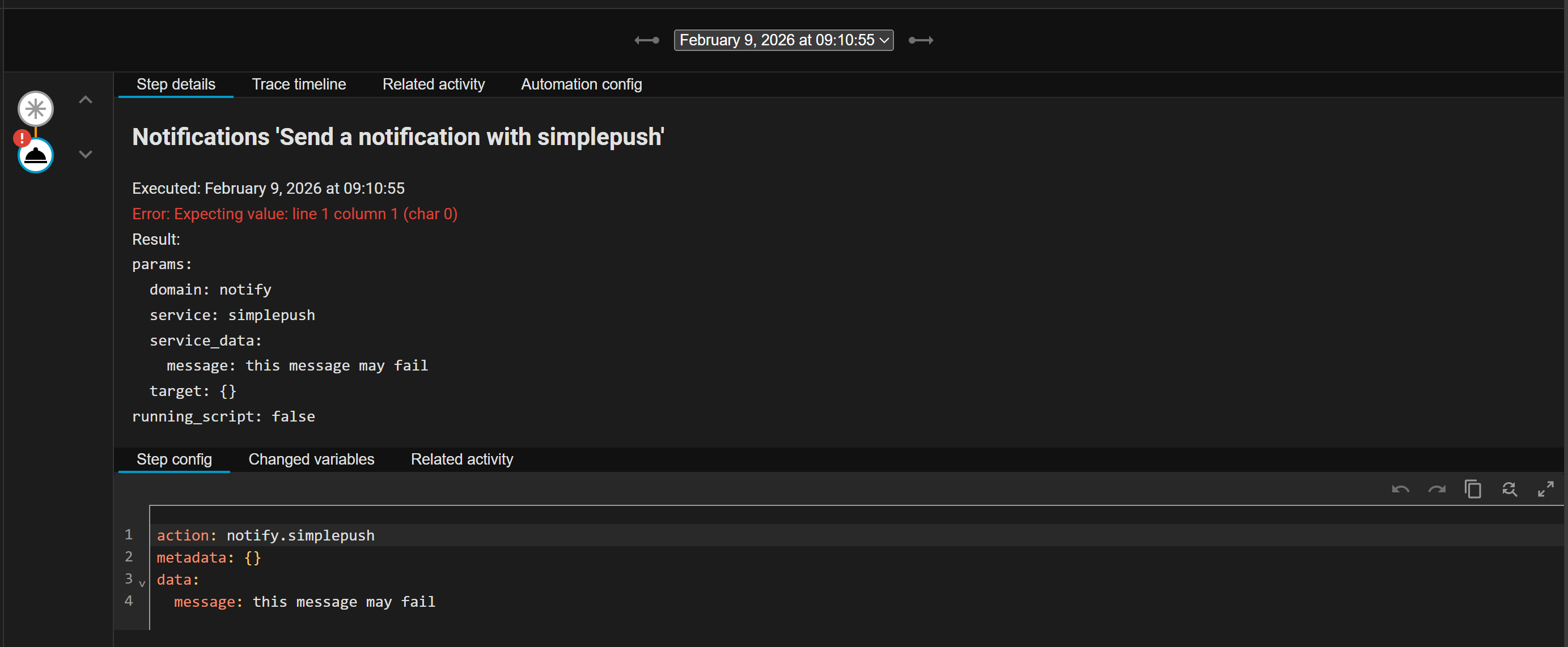

When it fail in trace it looks like this:
So it look like the problem here is:
Error: Expecting value: line 1 column 1 (char 0)
