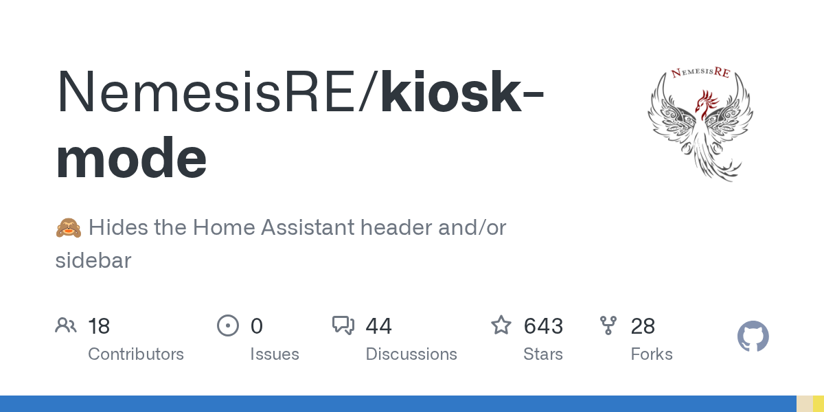

I’m playing with kiosk mode and trying to make the best out of it. ATM, I can lock them to the single dashboard which “good enough” for now. However, the 3 dots are available and they cans earch through entities and access them this way. If I can at least hide/disable that part, I might be able to make it work.
IE: I have helpers that allows me to toggle internet access for the kids. I don’t need my kids to be able to toggle themselves back on but still would like them to be able to trigger lights etc… in their rooms.

Unless I misunderstand what you’re trying to do, I accomplished this by creating different users and using Kiosk Mode.
It’s still possible. Kiosk mode only hides endpoints. What were talking about is… If one of your end users has a browser and knows the url they can jump right out of your carefully setup kiosk mode by specifying a well known url. (know the uslrl for settings… For instance?)
There’s absolutely nothing in HAOS preventing an authenticated user from doing that. It’s security by obscurity which any security pro. Will tell you is not security at all. It’s a wish and prayer.
Kiosk mode hides stuff. It’s convenient and will prevent the casual user. It’s not security. It’s not RBAC. Ruler across knuckles is more effective…
That’s right, I tried to clarify that in the third point in the Things that are out of the scope of Kiosk-mode section of the kiosk-mode entry. :slightly_smiling_face:
@dannieboiz, the best that you can do with Home Assistant right now is, as @NathanCu mentioned, security by obscurity. To avoid certain users visiting other dashboards that are not intended for them, you can copy this logic to a custom JavaScript module that check the user and redirect them to a specific dashboard. This is also security by obscurity but very useful for family members, kids, spouse, etc (as long as they don’t have a minimum debugging and JavaScript coding skills :slightly_smiling_face:).
