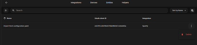

HA > Settings > Devices and Services > 3 Dots (Top right) > Application credentials. If you have a Simplisafe entry, click the 3 Dots > delete.
