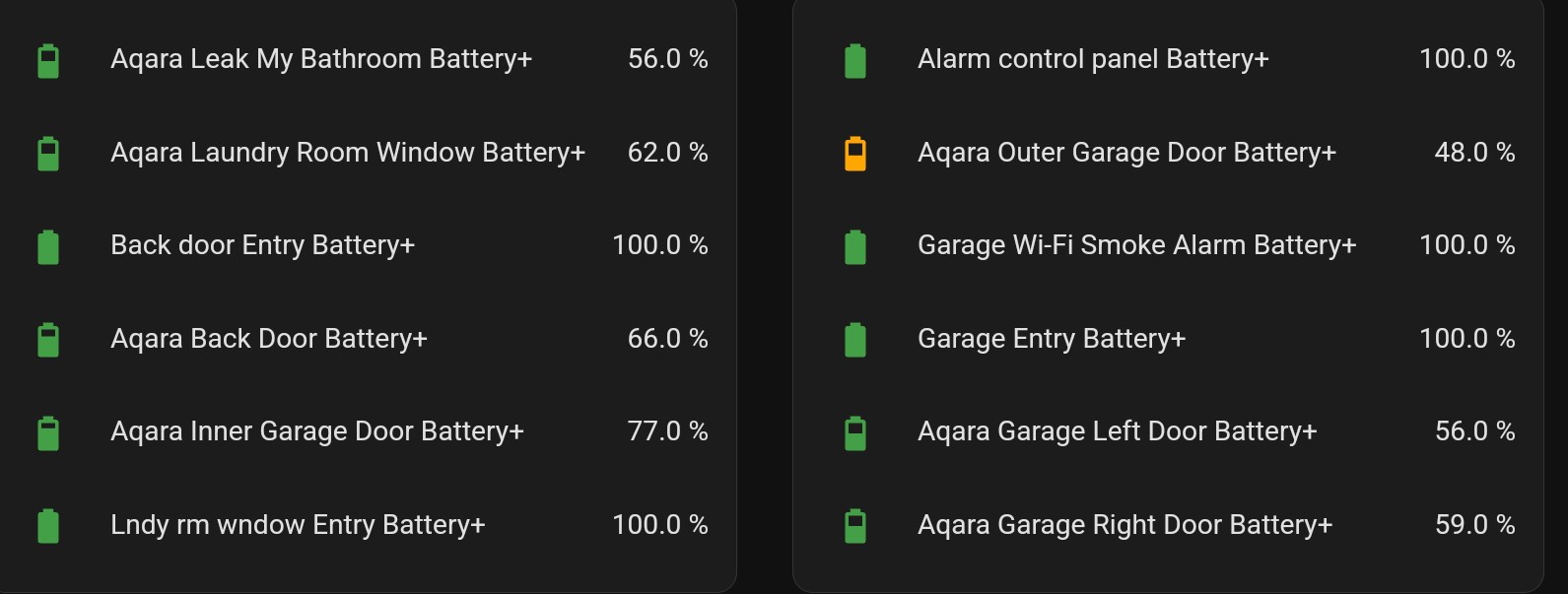

Last couple days and results to be determined, Battery Notes and Battery State Card to monitor the batteries (I hope). A little YAML and the SS normal battery state now reports at 100% and a low threshold I set at 30%. With 35 Simplisafe sensors and an equal amount of Aqara Zigbee sensors, keypad base Station, x2, that’s about 79 batteries. I’m no YAML expert. GitHub - nielsfaber/alarmo: Easy to use alarm system integration for Home Assistant

Batteries sample mixed.

I’ll warn you, SS sensors with Battery Notes is worthless. SS does not report battery level; it just reports when it needs to be replaced, even within it’s own system/app. I’ve year to get any useful information from SS in Battery Notes. I think this is a SS limitation, not HA or Battery Notes.

I also forced SS batteries to report percentage with helpers. Don’t know if they’ll report or not, as in pic above, SS show 100% instead of SS normal, minimum set at 30 percent in Battery Notes Config. TBD.

With SS being a closed system, a fellow on the SS forum kicked my old brain into gear.
With Ai help, I created a couple of helpers and templated a sensor helper in HAOS.
Just using averages of a CR2032 life span as used in a security sensor for example. Going around Simplisafe entirely.
I used 24 months life for now, some are more, some heavily used are less life.
That gets me a % of battery drop with the Jinja template sensor helper and I can adjust as needed, if needed.
It’s not perfect, but as close as I’ll ever get for Simplisafe in Battery Notes, auto entities added it to my batteries dashboard automatically.
Unfortunately, I’ll have to do it 37 times lol, for all SS sensors.:grimacing::thinking::sweat_smile:
