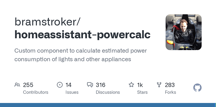

There’s a Youtube video on to use template sensors to create “simulated” power sensors (though I think that goes about it in a rather more complicated way than needed), and there’s a custom integration if you do not want to create the template sensors yourself:
