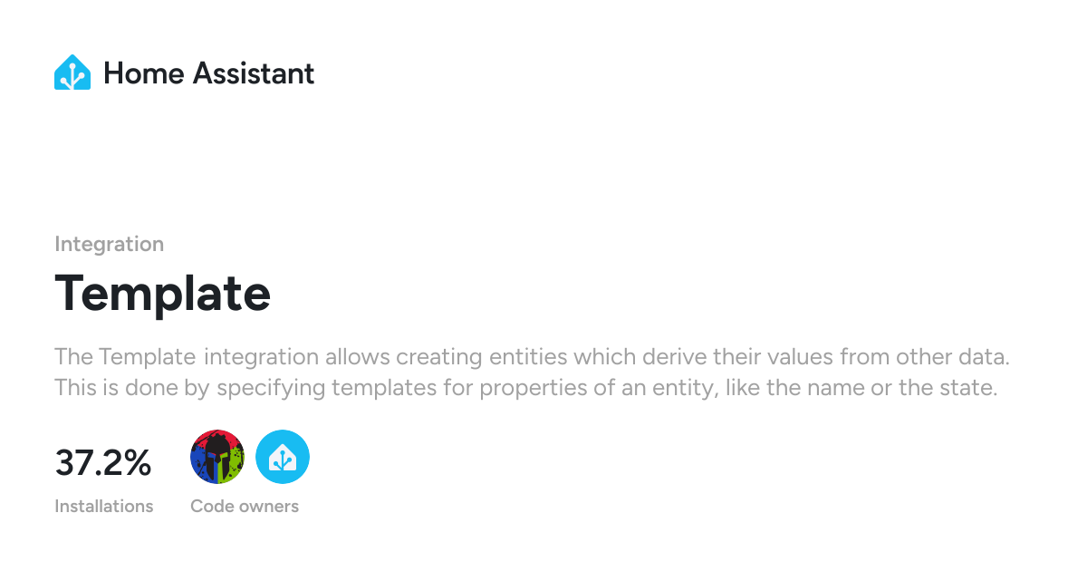

Probably the quickest way to get it working would be to use a light template:
That way you can configure a dedicated action for each UI action i.e. send a custom MQTT message in each case, depending on the complexity of the protocol you might need to track state (using input helpers). If the state of the light can be changed outside HA, you might also need additional automations to catch MQTT messages and update the state in HA,
It’s possible that there is a simpler solution, however specifics of what hardware and MQTT server you are using would be needed to provide useful advice.
